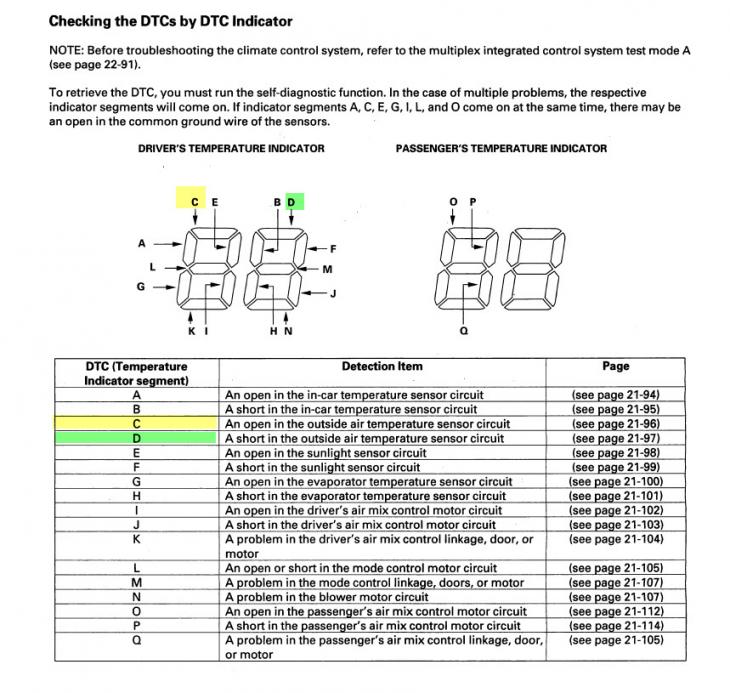

Posts: 7,101
It sounds like your car has auto-climate control HVAC instead of manual HVAC. The trouble codes are different between climate control vs manual A/C. HVAC number trouble codes are for cars with manual A/C. The HVAC alpha trouble codes are for cars with auto-climate control.
It is not manual A/C trouble code "8".
The trouble code you have is either "C", "D" or "F", depending on whether it is the left or right driver's side temperature indicator. (See attached image.)
C is an open in the outside air temperature sensor circuit.
D is a short in the outside air temperature sensor circuit.
F is short in sunlight sensor circuit.
If it is the outside air temperature sensor is located behind the front bumper (near the air duct). It is not the same as the sunlight sensor or evaporator temperature control sensor.
