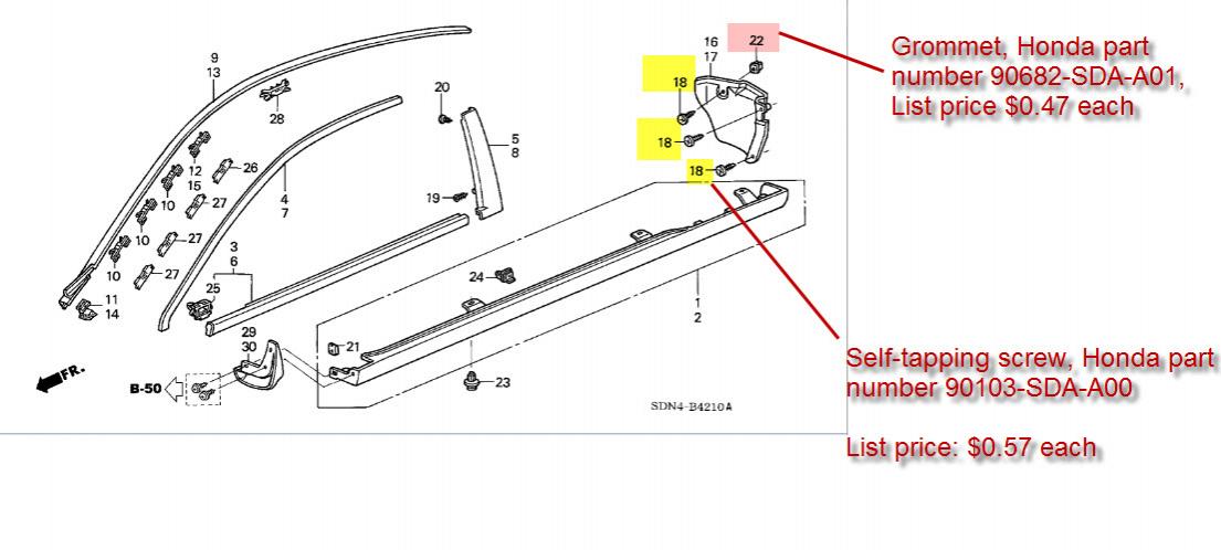

The screws and grommet are listed on the attached image.
Here are the install instructions:
http://www.handa-accessories.com/acc...lashguards.pdf

So to clarify, do the bottom two screws use the grommet, or just the Self taping screws?
I suppose I could look on the other side, but I don't have the car today.
Old Apr 24, 2012 | 10:02 PM
Posts: 7,101
It looks like only the one screw higher up uses a grommet. The bottom two screws does not use a grommet.
The parts list only two grommets are needed, meaning one for the left side of the car and one for the right side.
