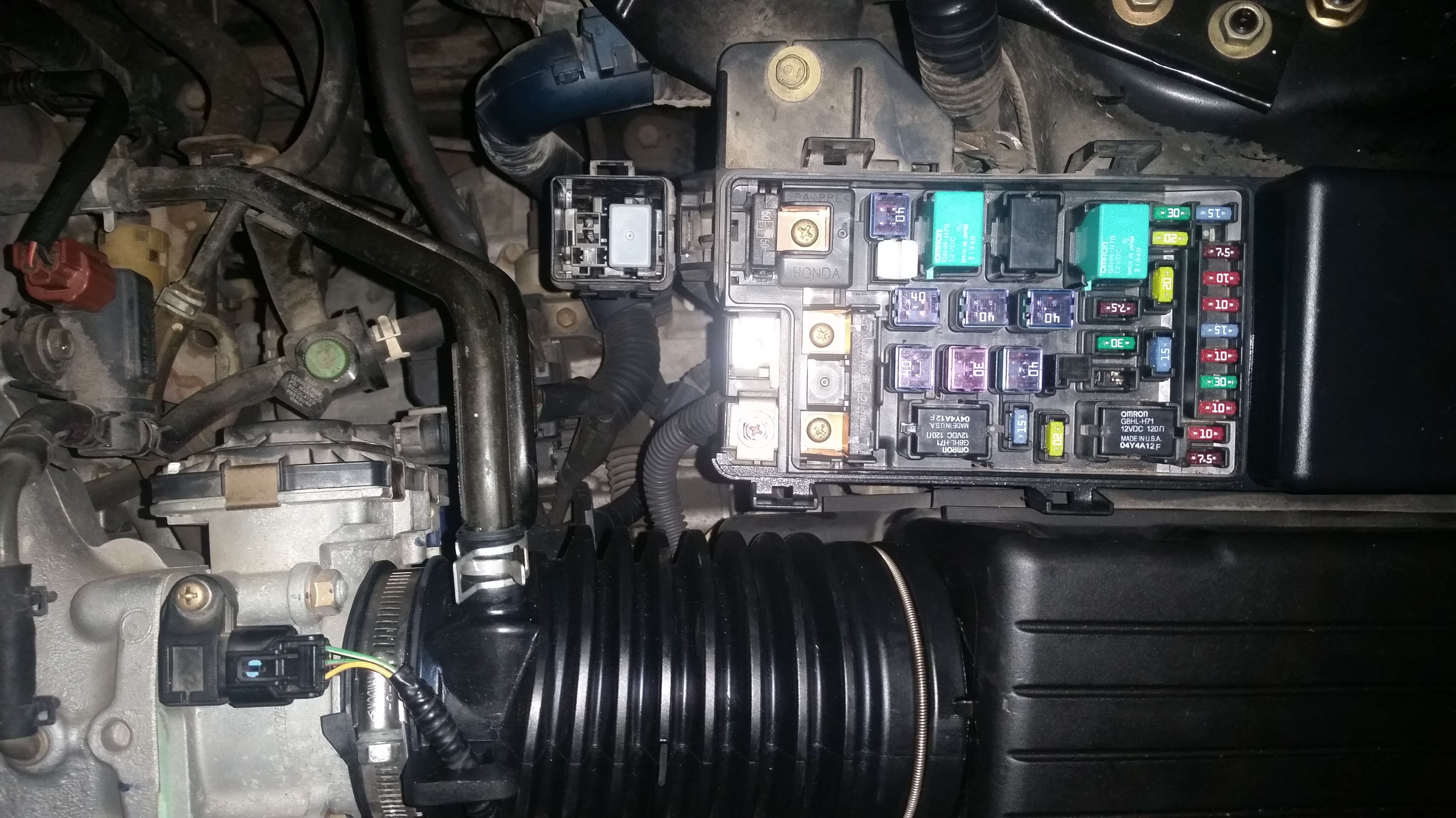

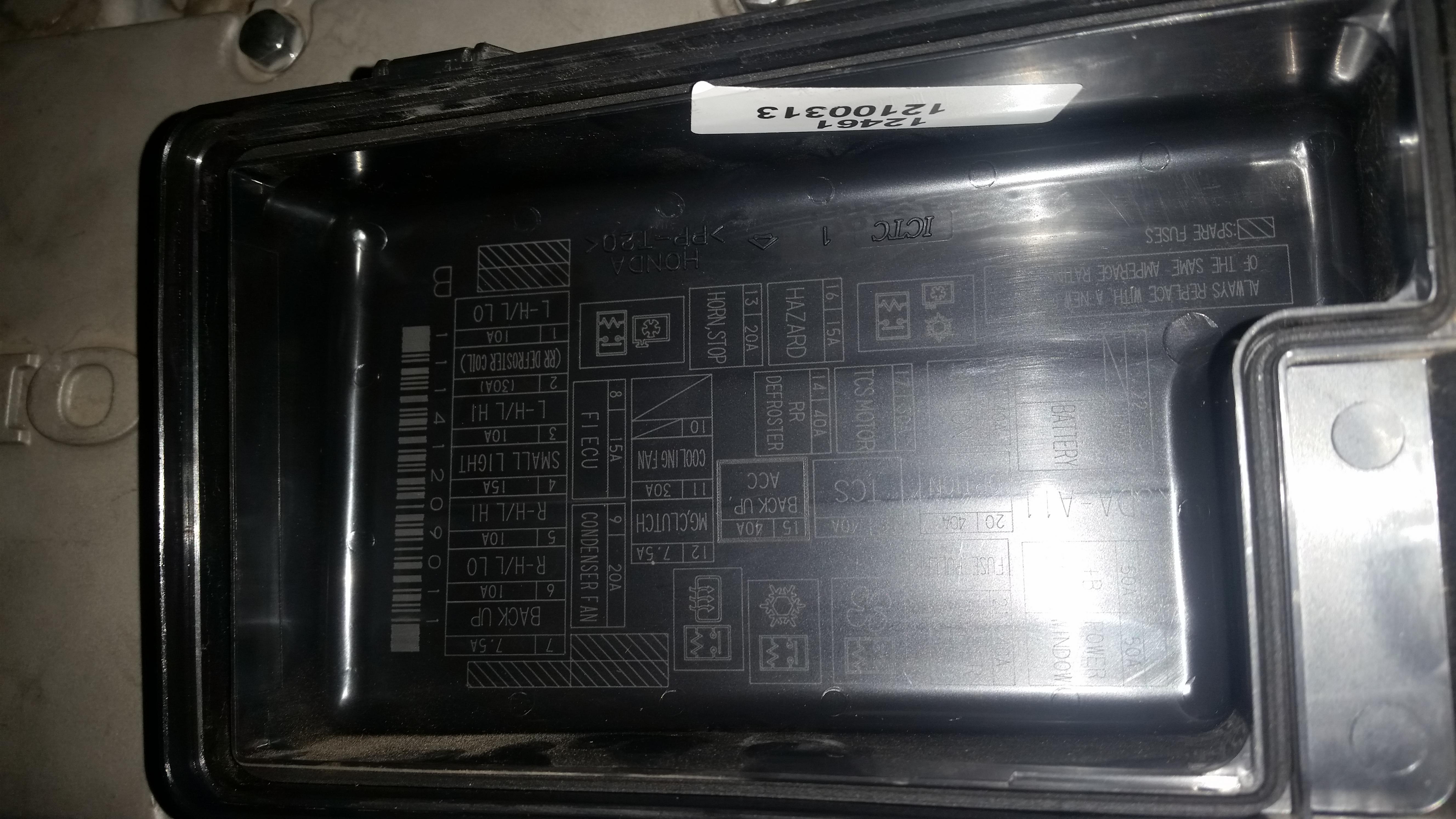

I don't see anything matching in my under hood fuse/relay box however I just noticed a small relay box left of the main box, it has 2 relay sockets and 1x 5 terminal mitsuba relay. Could this be it?

I followed the component location reference (Page 22-91 of 03-06 Accord 4-cyl manual) and found refeence to B-Can system and requirement to use HDS to interrogate. You will have to use Mode 1 & 2 manual scheme to check for DTC's.
Have you confirmed absence of ground at Pin 3 of compressor relay?
Old Jun 12, 2015 | 09:20 AM
Regarding Relay Control Module, it is apparently integrated into Underhood Fuse box. See Page 22-132 of 4-cyl Accord manual. This shows tests of module.
