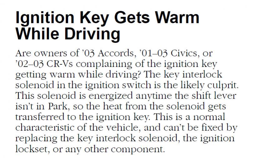

Is your car a coupe (2-door)? If yes, depending on your VIN (vehicle id number), it may be covered under a recall due to a stalling or no-start problem. Your VIN is on your car registration, on the driver side dash, and a lot of other places. See this Honda technical service bulletin. Copy and paste without quotation marks to view.
"http://dvpatel.homelinux.com/forumfiles/SB/A05-014.PDF"
You can also enter your VIN here:
"http://www.ahm-ownerlink.com/SEO/HondaRecall.asp?recallStatus=NO%20VIN&recallId1=NO %20RECALL%20IDS"
Even if it is not under recall, the problem may possibly pertain to the underdash fuse box. The fuse box is actually very easy to replace, only a few bolts holding it.
The hot key is normal, see attached image.
