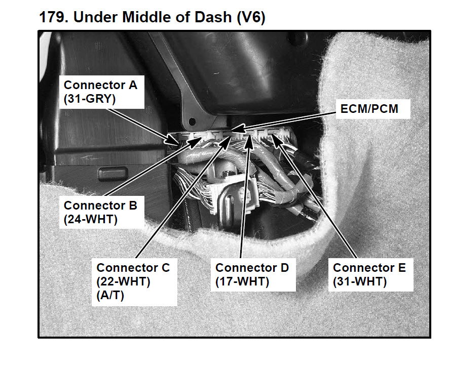

Ok, I found it, and Pin 27. with key on, engine off, I get WILD ohms #s. my analog one pegs past the infinate line, and the digital one says something like -1945 or something like that, when I touch black to pin and red to ground. Red to pin, black ground gets nothing.. odd, but...
Like the other threads poster, when I backprobed it, with relay in, engine ON, and AC on, testing for ground causes compressor to work..
So, like his, PCM bad, or is it possibly the thermometer in the dash is broke? It does have a dent in the vents.
Previous owner was a heavy smoker, so it MIGHT be something to check? (how??)

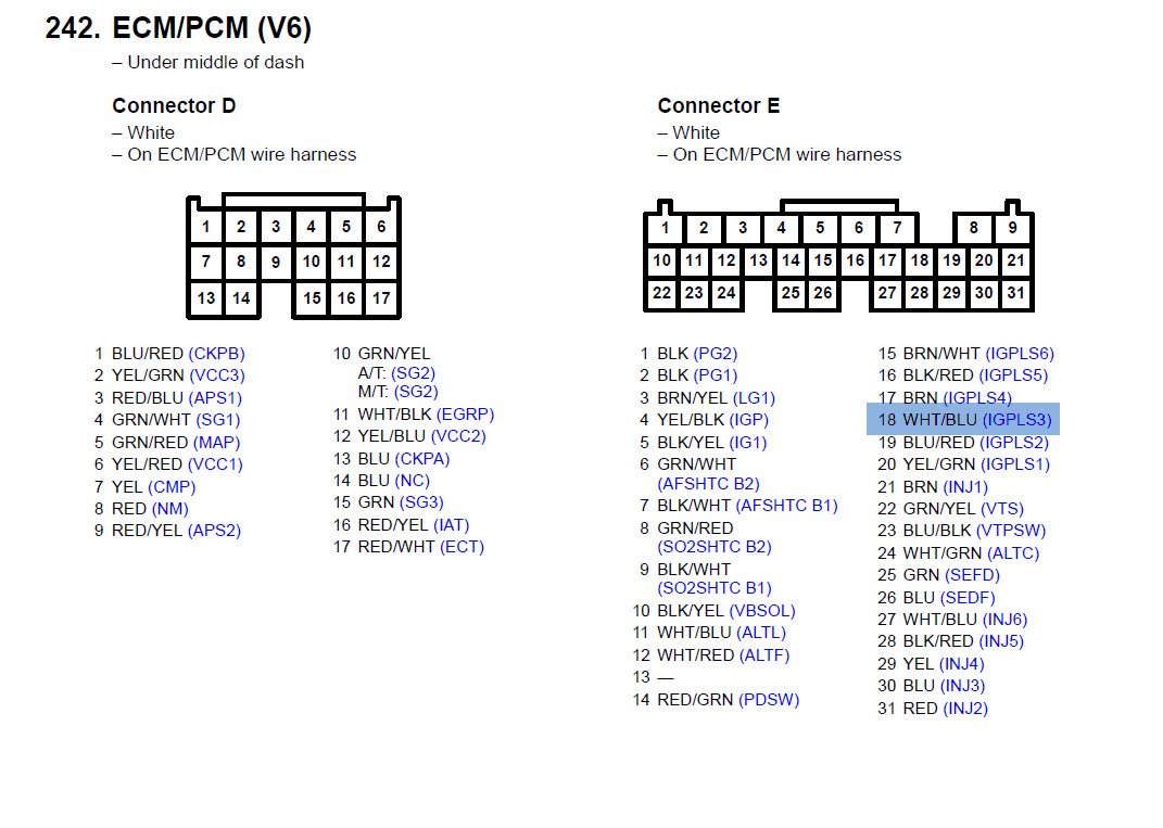

Backprobe Pin E18 at ECM to determine if ground is available w/ AC On. If no ground then fault may be in pressure switch or thermostat (evap temp sensor). Wiring, gauge control module, or relay module are also possible fault sources.

Ok, I think I got E18. No ground, but its a white or yellow and blue stripe wire..
If thats right, then what?

The ECM/PCM relay control wire is Red at A27; pin 27 of Connector A (31P gray connector) for a LX V6 with manual climate control.
For 4 cylinders with manual climate control, then the ECM/PCM relay control red wire is at E18; pin 18 of Connector E (31P white connector).
Old Jul 1, 2016 | 09:37 PM
JarvisW's Avatar
Joined: Jul 2016
Posts: 29
Its a V6, and I got OHMs at A27, and as above, when probed with engine running, the compressor comes on.
His next move was for E18, and I think I got it, I counted pins right to left looking AT plug side not wire side, then I flipped it to wire side and matched the slot. It was White or yellow with a blue stripe, not red tho...
I hate electrical issues lol
Old Jul 1, 2016 | 10:18 PM
The Wht/Blu wire at E18 for a V6 is the ignition control wire for coil no. 3.
Attached Thumbnails 05 LX AC Compressor not getting power?-pcm-connectors.jpg   05 LX AC Compressor not getting power?-connector-.jpg   05 LX AC Compressor not getting power?-connecto-e.jpg
