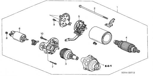

Not the main relay. When that fails the fuel pump might not run, but the starter would still crank the engine.
You might need the brush pack (#5) or the solenoid (#6).

Lots of 4-cyl Hondas use a Denso starter. But really, the same thing is true except the counterpart to those contacts are inside that #6 solenoid.
If access to the V6 starter is a real pain, you might want to take a close look at all the other stuff in the starter (bearings, brushes, etc) so you don't have to remove it again anytime soon.
