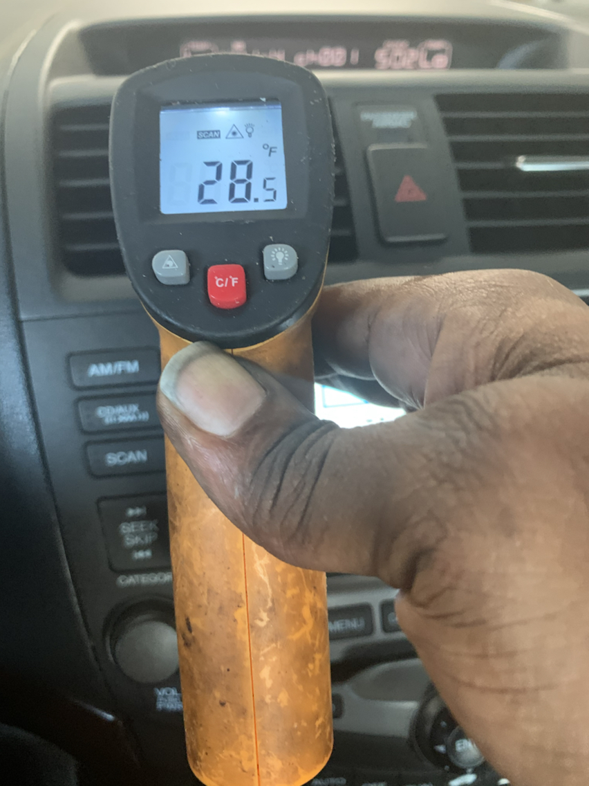

I finally got everything back together. I decided to change the evaporator also so a complete new system under $300. It is up and running with no issues.
