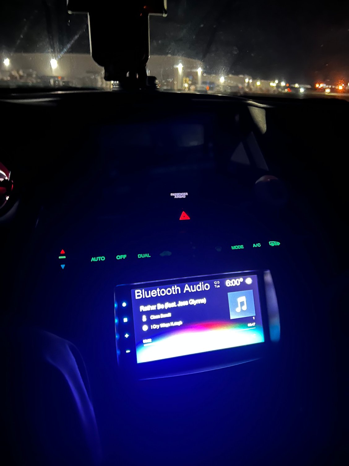

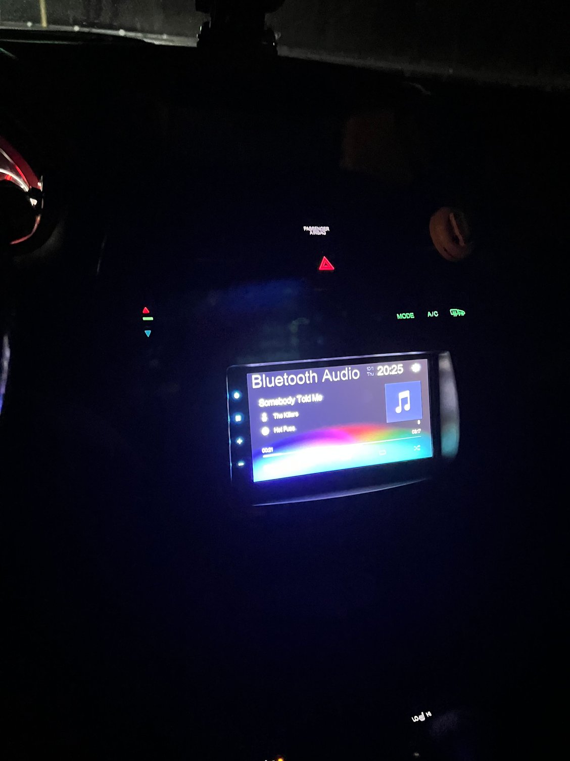

I’ve noticed that randomly some mornings on the way to work my climate control unit will light up all the way and other mornings it won’t. I’ve included two pictures one from yesterday and one from today. I have not changed any wiring or even had it apart between these two photos either.
