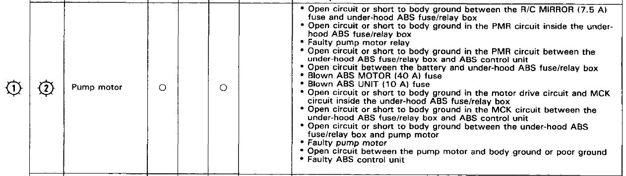

my abs light is showing the 1 then 2 light flash. imy understanding is its the pump. anything else it could be? do i purchase the pump or whole module? what years fit what? mine is a 94 accord with vtec.

I believe that you have to buy the whole module. I think that all 94-97 accord ABS modules from 4-cylinder engines will work in your car.

Just me but there are a few other things this could be....
Bad realy, blown fuse, ect, ect.
Don't get me wrong at the end of the day it maybe the unit.
