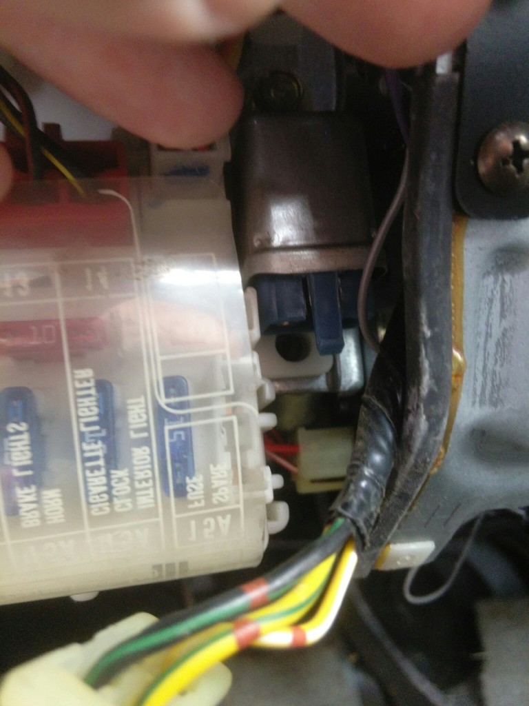

WORKING!
Things that I've learned include not trusting a clicking relay, knowing my voltmeter better, and having a kick in the butt to get things done is the key success.
Here's a couple pictures (location of the part and more):
