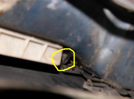

DX, LX or LXi-(or another way, carb'd or FI-if carb'd, power windows or not)? Could help with getting to the alt, I know the issue is gone for now but in the future? Will also help with the leak. Pass side tail light gasket or if an LXi (4 dr) also check the rear sun/moon roof drain. I've posted a pic of the left/drivers side location before but can re-post or take one of the pass side and post that.

4-door, FI, power windows with sun/moon roof. I would actually like to see a picture since I have had some water come in before. It happened a couple of times after a good rain. I hit the brakes and a nice icy surprise came down my neck.

There's a hose in each corner of the framework, acting a bit like a drip tray. If the hoses are plugged, water will collect in the tray & pour out when you turn or brake.
Old Mar 23, 2011 | 07:33 PM
This is the left/drivers side rear drain. Should give you a good idea of where the other side is as well. From the rear, looking up between the "bumper" shell and the body you should find this. Look for the white plastic piece first, then look for the little tube. I use weed eater line to clean it out when it gets clogged...BTW you might get a little wet.
Sounds like, guess, your issue is with the rear, hit the brakes-water moves forward- and you get wet. And there is water in the trunk. However if this happens while backing up, then I'd say you have two issues. One, tail light leaks. Two the front drains are clogged-have pic's of those as well.
