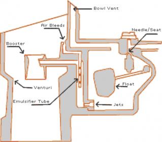

Take a look at this picture. If gas is pouring into the engine it's normally one of two problems, the float or the needle/seat.
If you have ever opened the top to your toilet you will pretty much how this works. The float drops as fuel is used opening a gap between the needle and seat refilling the carb "bowl" with fuel. Sometimes the float gets a hole in it causing it to not float anymore allowing too much fuel in the bowl. Just as would happen with a toilet, if the bowl (or tank as it's called in a toilet) it over flows and in the case of a carb, the fuel goes out the bowl vent, and down the throat of the carb.
Since you mentioned the car has been sitting, it's also possible dirt has gotten trapped between the needle and seat causing the same issue.
The carb is made from several pieces and often you can access the float by removing the top half of the carb. Here is the trick, if you have to replace the float or needle/seat, you have to set the float so it closes the needle valve at the correct fuel level, or the car will not run correctly.
My personal advise is this has gotten into the realm of a professional. Unless you have tinkered with carbs before, you may end up costing yourself more in the end. The last carb equipped Honda's were some of the most complex parts on the car due to emissions and unless you are familiar with them, they can be a bear.
YMMV

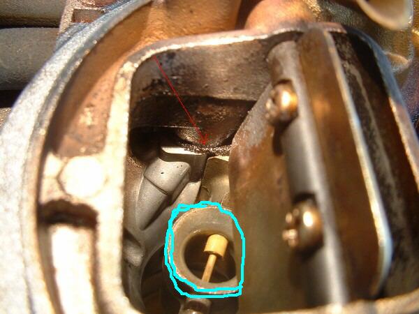

Can you take a pic or two of the carb and point out/show where the gas is leaking into the throat of the carb?

The needle is not seating.
In the pic I posted, see the bad "paint circle" in a light blue. I that where it is coming from?
You should never be able to see gas/liquid going down the throat of the carb.
The "float level" was good? Can you give more info on this? The sight glass on the side should only be "half" way full.
On the 87 LX I did this on, the float had to "sit" above a tab that did not let the float swing "all the way" down.
So again, what does the fuel level look like thru the sight glass?
