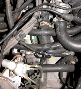

Being a manual trans brings another "possible" into play ...you didn't see a funny looking piece of blue plastic in the floor board - like a piece of blue crayon?
Follow the lower hose from the rad to the engine - about six inches below where that hose connects to the engine is the starter.
There are two "cables" going to it. One is a small spade connection - upper. The other is a larger cable that has a nut holding it on.
When "someone" tries to start the car, the small one should have 12v to ground.
This pic is from my 88 LXi- look for the "green thing"...that is the starter, the cables are almost dead center below the hose - the big one with the rusty clamp - leave me alone guys on that.
EDIT: Your starter may not be "green" like the one here - I had to replace this one - some years ago.......so this is a pic of the aftermarket one on the car.
and for anyone else - remember the rad hose connections changed from the 3rd to 4th (and newer) gen accords - meaning the t-stat is in the UPPER hose on a 3rd gen.

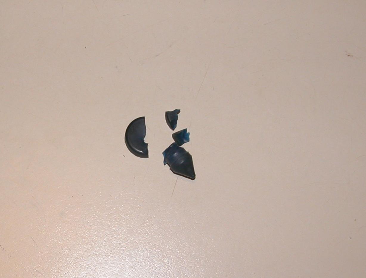

There is a "plug" that goes into the "hole" on the clutch - two switches if you have cruise - and on the brake pedal. These plugs are "blue" color OE, after time they break. Meaning you will find blue plastic pieces in the floor board. The stem that goes thru the hole is about the diameter of a crayon.
Got home on Tuesday and the brake lights in my 89 LXi were staying on. Looked in the floor board and guess what - blue plastic pieces. Went to the dealer and spent ~$2.30 and good to go - the new ones from the dealer are white in color. Pic of the pieces, at least the ones I found from Tuesday attached.
The upper switch on the clutch pedal has this same "stopper/plug", which would cause the car not to start as this would not allow power to the small BLK/WHT wire of the starter.

To add, the lower switch that closes when the pedal IS NOT being pushed is for the cruise control - I'm guessing it isn't working on this car.
The upper switch that closes when the pedal is pushed is the inhibitor - this is for the starting system.
