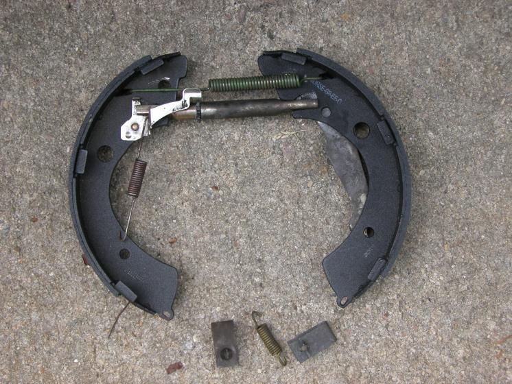

The trick.....you don't even remove it until the shoes are off the car.
Next time I do this I really need to take more pic's and do a proper write up.
Here we go, from memory.
Once the drum is off, sometimes you have to adjust the shoes "in" to get them to clear the drum.
Remove the lower spring on the shoes. Remove the "pins" from the shoes/backing plate. If the shoes have been on for a bit of time, press the top part of both shoes - to compress the wheel cyl.
Slip the lower part of the shoes from around the lower "block/pin/anchor" point. pull gently on the lower part of the shoes and they will spread enough to do this.
Then hold the lower part of both shoes and "push" them together enough to get the upper part off/clear the wheel cyl. Be careful not to pop one side of the wheel cyl out.
Once off the wheel cyl, let go of the shoes. Tilt them down from the top and remove the e-brake cable from the lever.
BAM....shoes off the car and on the ground with the top spring and adjusting screw still in place
Once on the ground, slightly twist the shoes from the outside in. The top spring/adjuster/adjuster arm/adjuster spring will pretty much just fall off.
To install, reverse. Install the "upper" part of the brake shoe set up - don't forget the e-brake lever - while the shoes are on the ground. The set up on the ground, before installing will look something like this pic. Notice the adjuster lever spring is left off - just seems to help on the install, if it falls off during the install. Don't worry, it can be installed really easy once the shoes are back on - just be sure to get it set correct.
Me, done this a few times - shoes off and on the ground in 5 minutes, back on in about 10 more. 5 for transfering the old or new hardware to the shoes, another 5 to put them back on. But I take a break between steps (beer )
