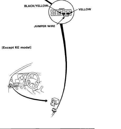

Old Dec 24, 2012 | 08:43 AM
Jump the wires to the relay......verify if voltage is going to the pump by checking at the pump with a test light or volt meter.
Double check all of the fuses under the hood.

all the fuses under the hood are good. and my check engine light doesnt come on. and i have no blinking light on the ecu but the car will still start up on starter fluid and will attempt to run.
