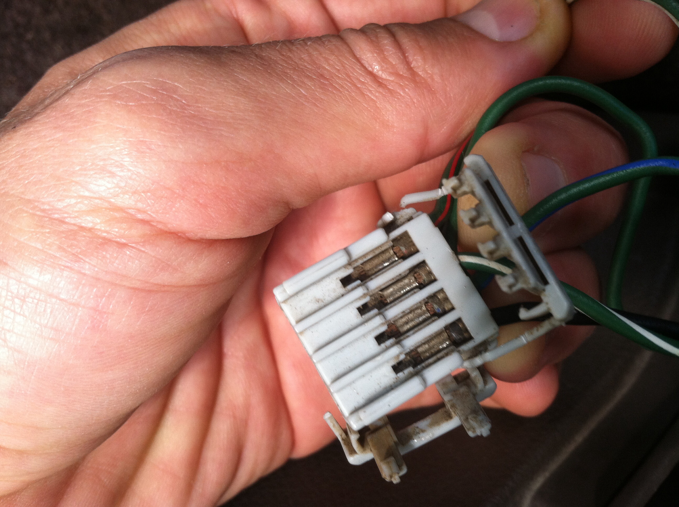

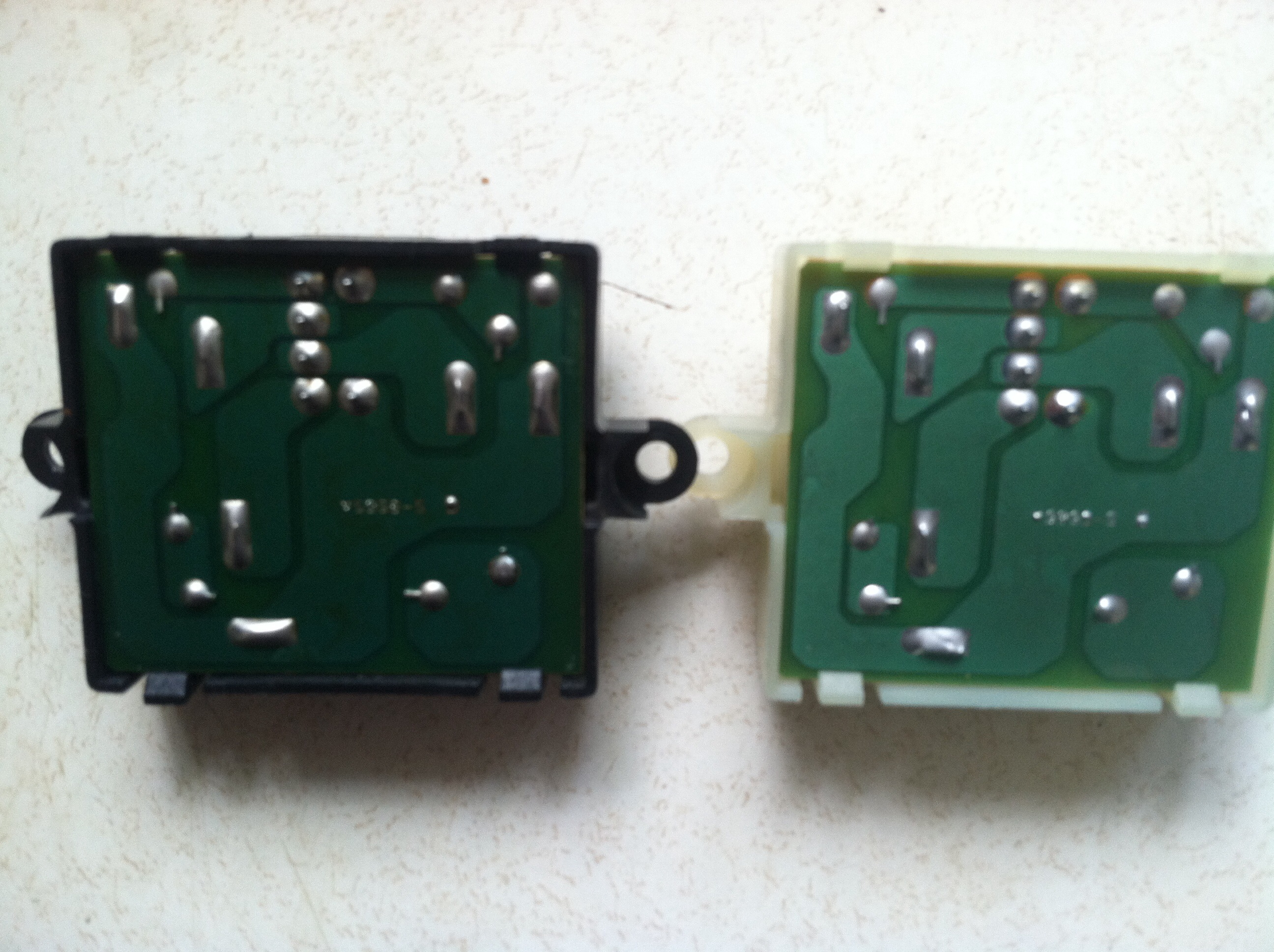

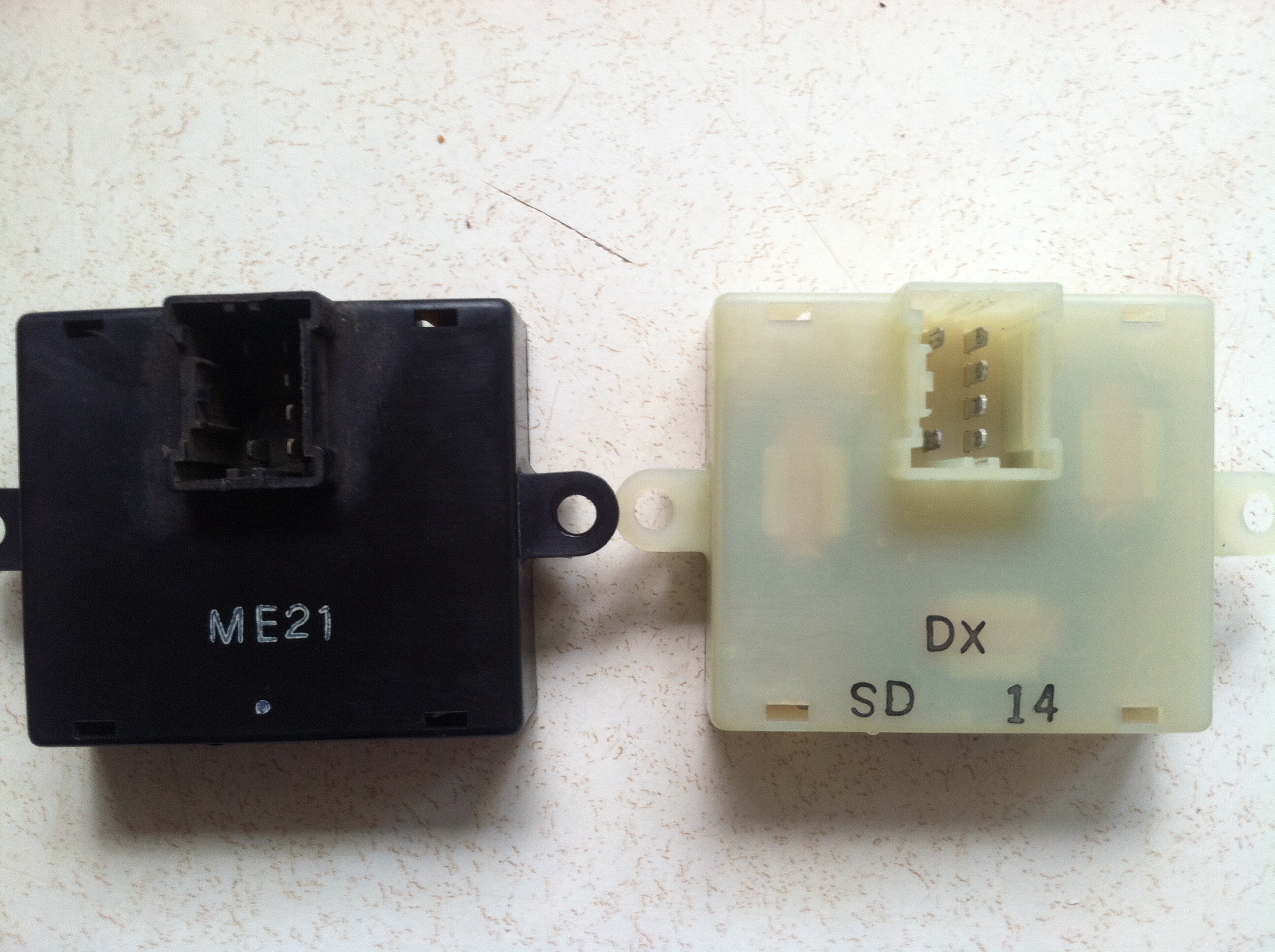

I've been working on this the last week. Went to the junk yard to try to pull a taillight assembly from another 1990, but they were all gone off the one 1990 they had. So that doesn't seem like an option unless I drive to New Orleans and look there.
I'm attaching photos (front and back ) of the two failure sensors. The black one is the original. The white one is the replacement sold by the dealership. They are both 6 pin. Despite having different number/letter on the front, the boards seem the same. (Also attaching a pic of the failure sensor connector in case someone can see something wrong there).
Feeling more stuck than ever. I'd buy a replacement assembly but can't even find one online. Only a matter of time before I get pulled over (and again and again if i can't fix this). Any suggestions y'all might have...I could use them.

Just to close out this thread: the problem seems to be in the 6 pin connector running into the brake light failure sensor. Attempts at cleaning it failed, so I opted for the low tech (and partial) solution of jumping the Green/White terminals with a paper clip. Doesn't completely solve the problem (no high center light) but it does lessen the chances of getting pull over enough that this old car is driveable. When I'm in a bigger city, I'll probably try to pull a tail light assembly to completely fix.
