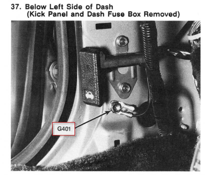

The indicators are grounded by Ground G401 (see image). Check the wiring and ground bolt. You may want to clean up the bolt mounting area with some sand paper.

Ok I will check that in a minute I was told it may be a ground or burnt wire issue
Old Dec 21, 2014 | 12:31 AM
Tyler Hollingsworth's Avatar
Joined: Dec 2014
Posts: 9
Ok that ground is good sanded it and cleaned it off and still nothing

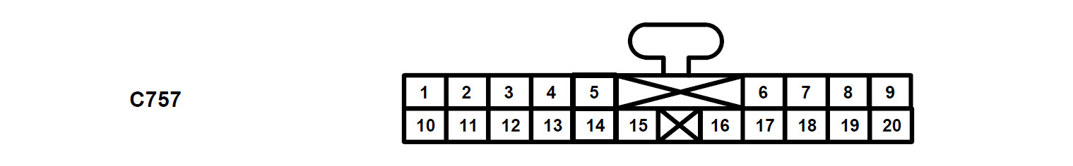

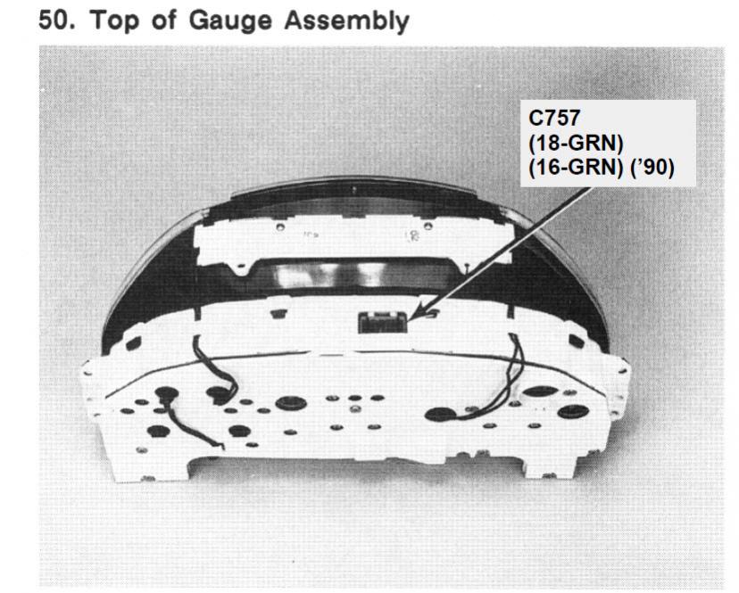

  2. If there is battery power on both sides of Fuse No. 1, then check for power at the Yellow wire (terminal pin no. 6) at Connector C757 (the green 18-pin connector) that plugs into the top of the gauge assembly. (Look at the wire side of the female connector to determine the pin numbering, see attached image.)
If there is battery power at the yellow wire (terminal pin no. 6) at Connector C757, then test the ground source (-) coming through the Black wire from Ground G401:
At the terminal no. 13 (black wire) at Connector C757, test for continuity to Ground G401.
To test for continuity, set the multimeter to either the "ohms" or the setting it will beep when you hold the two leads together.
  • If your meter beeps, it means you have continuity.
  • If it is on ohms scale, you will have continuity when it reads close to 0 ohms.
  • If it doesn't beep , shows OL (open line) or a 1 (infinity ohms); it means you don't have continuity.
Don’t turn on ignition for this continuity test. Touch one end of the multimeter to terminal pin no. 13 and the other end to Ground G401. There should be continuity to ground.
