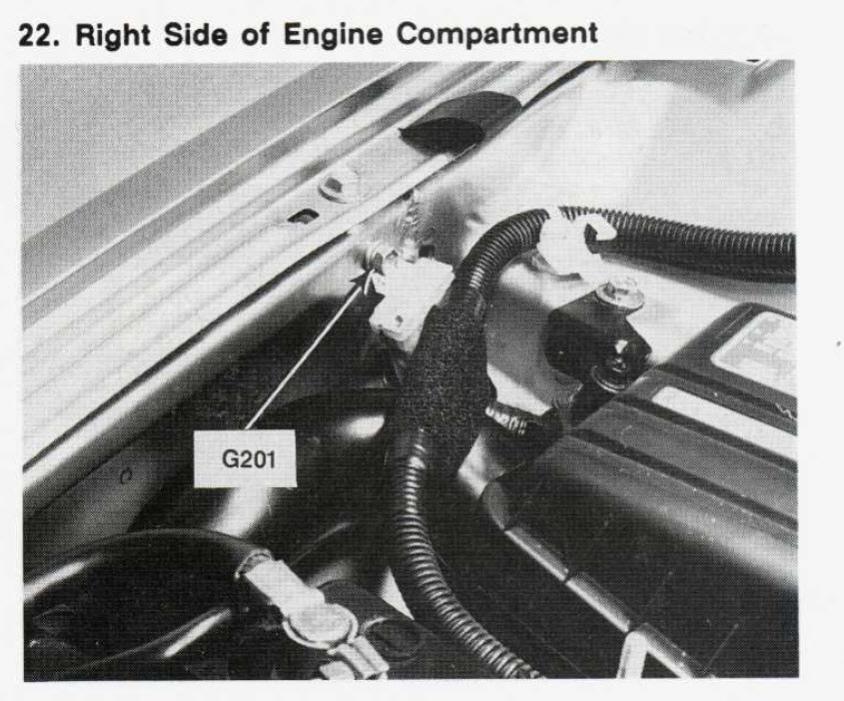

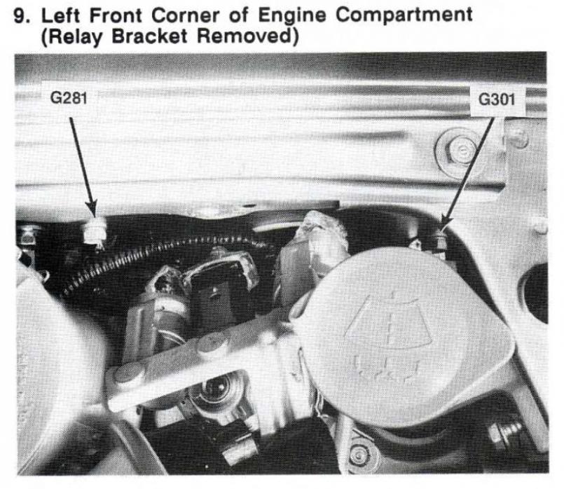

Posts: 7,101
Grounds G201 and G301 are located differently on a 91 compared to a 95.
G201 is located on the right side of engine compartment, on inner fender panel.
G301 is located on the left front corner of engine compartment, on inner fender panel.
Attached Thumbnails 1991 Honda accord lx blinker problems-ground-g201.jpg   1991 Honda accord lx blinker problems-ground-g301.jpg

Posts: 9
Okay I will check those out sometime when the rain slows down today
Old Dec 23, 2014 | 05:37 PM
Tyler Hollingsworth's Avatar
Joined: Dec 2014
Posts: 9
Ok cleaned those grounds still nothing different. The only think that has helped is cleaning the instrument cluster circut board.. I think I'm going to try to find one of those localy for cheap I hope
