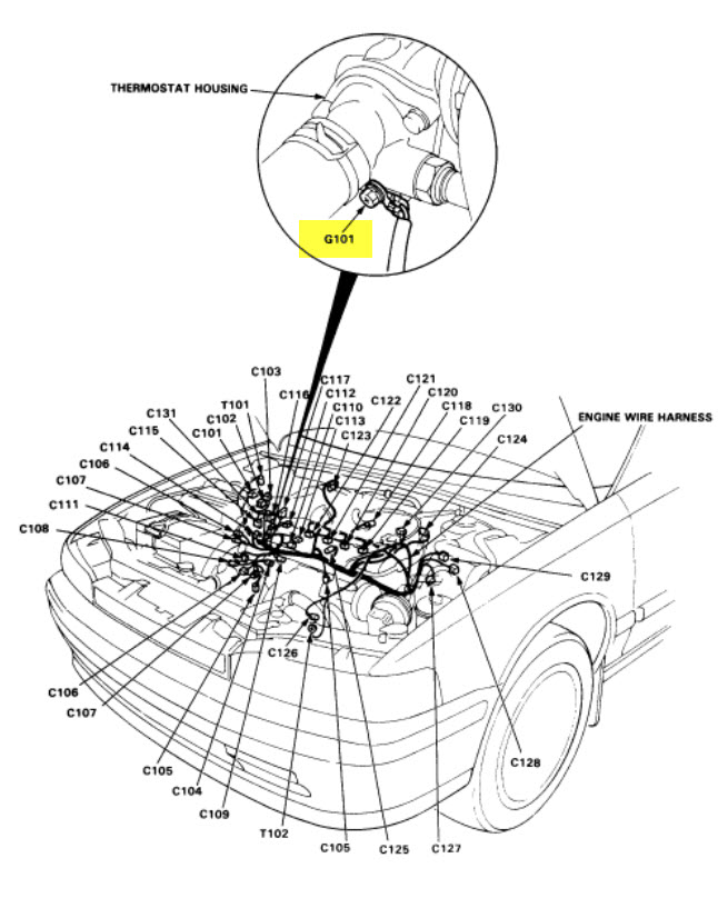

Is the ECU ground wire securely attached? On your car, it should be the ground wire that connects to the thermostat housing (lower radiator hose).
Old Jun 24, 2012 | 02:45 PM
See this pic. for what I am referring to ground (G101).
https://www.hondaaccordforum.com/for...d-location-jpg
