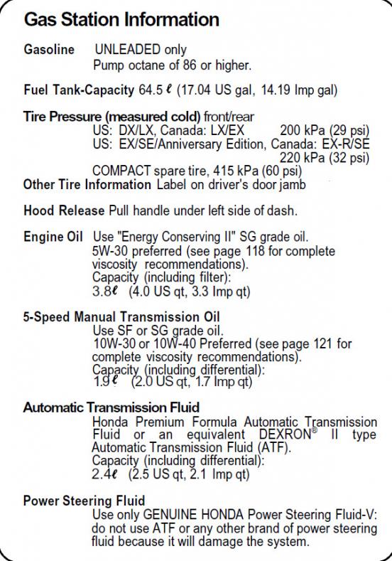

Posts: 7,101
17.04 U.S. gallons (see attached).
Attached Thumbnails 1993 LX Gasoline Fuel Tank Capacity-gas-station-info.jpg

65comet's Avatar
Joined: Oct 2012
Posts: 11
Yeah, that's all I've found anywhere. Guess I have to open it. Thanks. I'll update with what I find out. Who knows, maybe it has a collosal dent that changed the capacity. Or maybe someone swapped the tank. Or someone changed the fuel pump and pickup but got the wrong one. Or, I'm hoping for, just a bent pickup.
