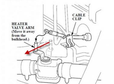

So I checked, when I turn the AC on, both fans come and compressor does engage and run too.
I checked the position of the heater hose lever, it does change position if I move the temperature **** to cold or hot vice versa. Valve movement is in counter clockwise if I use AC and clockwise if I am using heat settings.
Please see the pict below from the 'RedBull-1' pictures:
Anyway I can get a pict of blend door adjustment? How much pressure needs to be there in High and Low side? Also, I need those manifold blue gauges, right? If so, I can rent it from Autozone, right?

For giggles, pop the "clamp" off the valve - the one that holds the cable to the heater valve. Manually move the lever on the valve to the closed position as noted in the info posted by redbull.....see what you have?

Here is another thing, so today in the morning weather was kinda nice outside.
I again, ran the fan while temperature **** was at the coldest position.
It's throwing just fine air and not SUPER hot as I mentioned in my previous post.
So it feels like valve movement is just fine, I still have to follow the advice of PAHonda.

On a cool am - turn the car on and let it run with the ac off and the **** to cold. Once it gets to op temp, check the temp of the air coming out of the vents compared to outside temp.

I tried your idea and temperature remained almost the same as outside.
It rules out the idea of a bad valve, going to rent the gauges and test the pressures.
