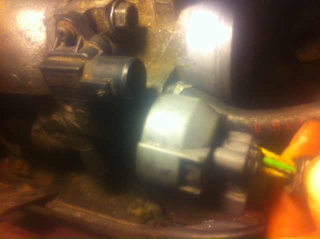

Old Jul 7, 2013 | 07:11 AM
What are the color of the three wires you have connected to the MAP sensor?

Posts: 288
Please see the picture attached, it seems like '2' yellow and '1' green.
I am really thankful and grateful to you for helping out.

Old Jul 7, 2013 | 07:40 AM
Please pull back the cover a bit and confirm that the wires to the MAP are YEL/WHT - GRN/WHT - WHT/YEL. Looks and sounds like they are correct - the connector for the MAP and TPS are the same shape/size and sometimes after work like you have done they get switched.
While waiting on the other repair - recheck the timing marks and the valve lash.

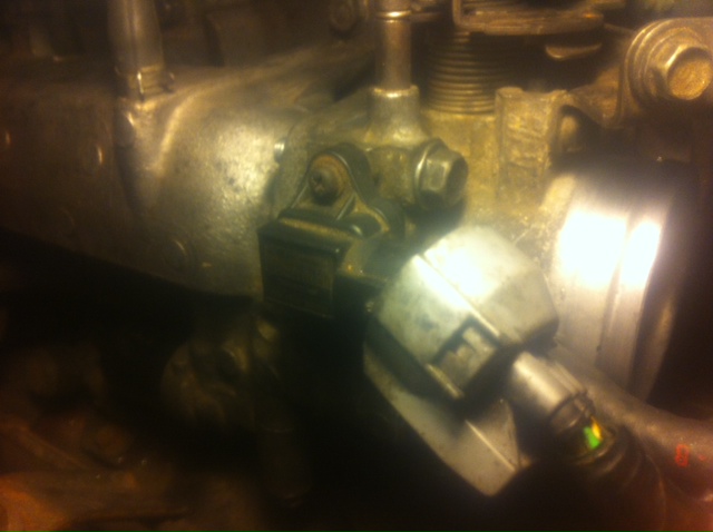

Posts: 288
Thanks again, please have a look on the new picture.
It seems like White/Yellow/Green or Yellow/Green.
Yes, I am going to check and fix the timing marks and valve lash, for valve lash.
As soon as I feel feeler gauge has a drag, should I tighten the locking nut with a box wrench while keeping the screw driver in place?

Old Jul 7, 2013 | 08:49 AM
Can you "zoom out" a bit. It is early but that "looks" like the TPS?
EDIT: Never mind - I turned my computer side ways and had some more coffee

Hahaha, thanks for helping out again.
I am actually pretty sure about the MAP sensor because it's wire is larger compared to the TPS, but again mistakes happen and of course I am in learning phase so please feel free to correct.

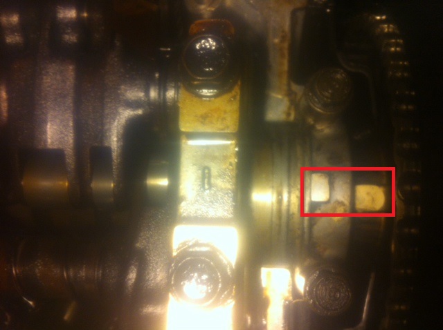

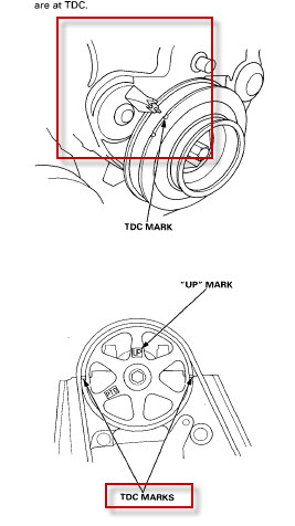

OK, another quick question, in order to perfectly adjust the timing, Crank is the best way to go since I pulled the camshaft while doing the HG by sliding the belt off of cam gear, right? Please have a look on the attached picture from the FSM.
Also, grove on the rocker arm assembly needs to be aligned with the "Up" mark on the Cam gear or it's not relevant? Please see in my 2nd picture.
Because if 'Crank' is the best way to go for TDC, I will just remove the rocker arm and adjust the cam gear 'Up' accordingly.
Looking forward to a response and help.
