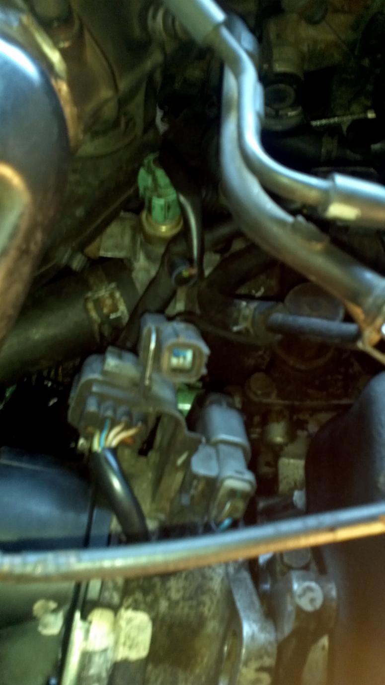

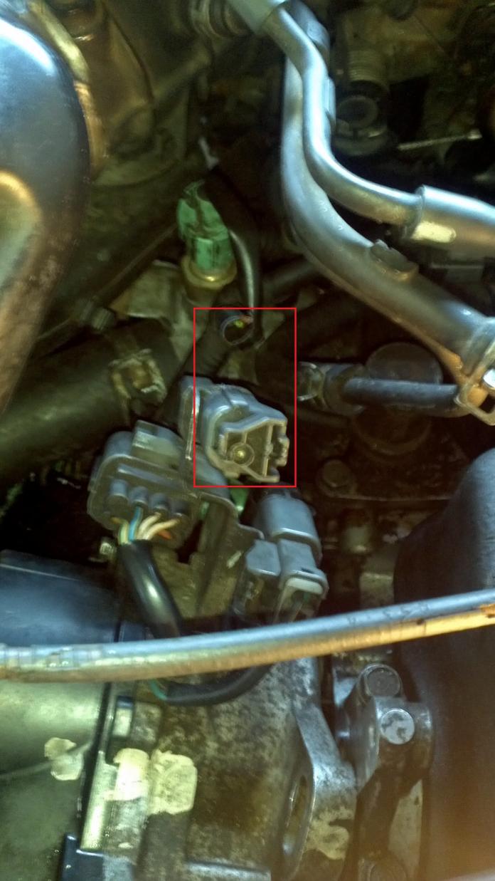

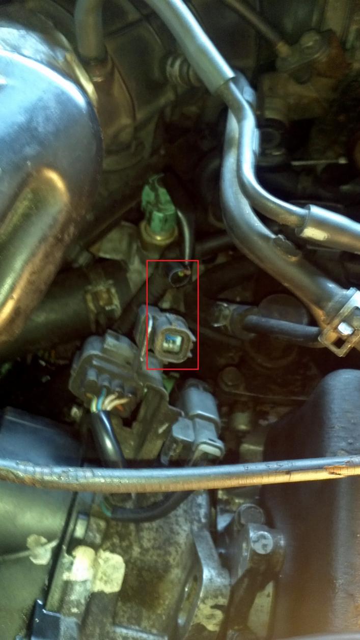

Please have a look on the attached pictures.
One Green color single wire is attached to this sensor and it broke today .
Same sensor is attached to VTEC solenoid as well.
Will it let the car start/run or no? Also, can I fix it by myself because wire kind broke, right at sensor edge
Attached Thumbnails 1994 EX---What is this sensor and will it let the car run?-2013-07-13_15-52-03_969.jpg   1994 EX---What is this sensor and will it let the car run?-2013-07-13_15-51-49_914.jpg   1994 EX---What is this sensor and will it let the car run?-2013-07-13_15-51-40_42.jpg
Old Jul 13, 2013 | 11:14 PM
Posts: 7,101
That is the connector for the VTEC valve, which is part of the VTEC control solenoid valve assembly.
The car should be able to start and run like that; however, it will affect the VTEC operation which would normally occur at higher engine speeds (around 2,300 - 3,200 rpms, depending on manifold pressure) and under other conditions.
That connector plug is a little different than other types of connectors which have terminals that can be pushed out/released with a tool to repair the wire connection. -- Your best bet might be to go get the plug from a salvage yard and splice the grn/wht wire to the replacement connector.

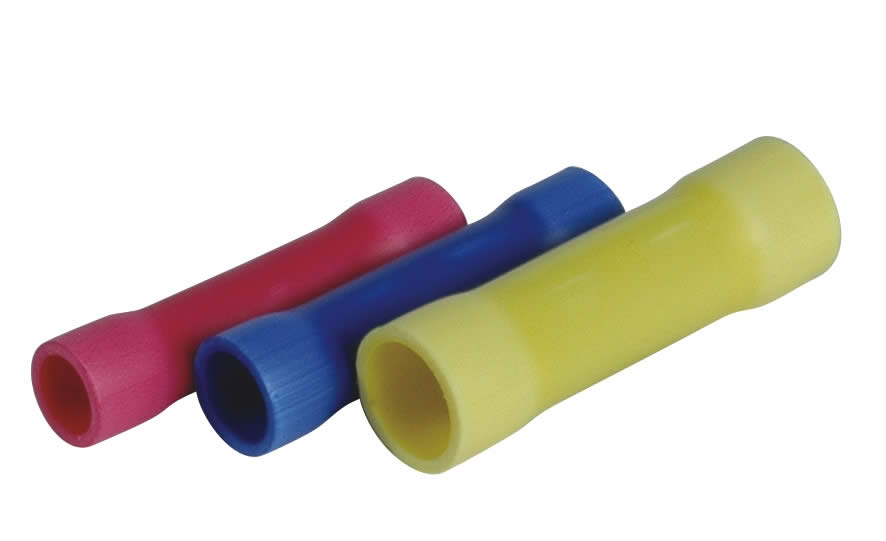

At the very least butt connector the wire in instead of just taping it.

You mean, wherever I have used electrical tape, use butt connector instead of the tape? Or use butt connector only at the wire splice and rest tape is fine?
Because I am using nearly 4 inches of electrical wire spliced with the green sensor wire. Then I have wrapped duck tape around the wire joint, as well as all ONLY electrical wire area.
Old Jul 15, 2013 | 09:04 AM
If I am understanding correctly you twisted the two wires together then taped over it right?
The right answer is to solder and heat shrink it. But the butt connector is a good second choice. With high engine temps and moisture the duct tape will lose its stickiness over time and fall off leaving a bare wire.
Is the wire you spliced in not insulated(rubber/plastic coating on it)?
Old Jul 15, 2013 | 10:58 AM
Solder the wire for a good connections.
Heat-shrink tubing would be best.
Electrical tape next, but engine-bay temperatures will probably soften the adhesive and it'll come unwrapped.
Duct tape will eventually get hard, brittle, and porous to water. It'll maybe allow electrical short through the cracked-up tape.
Old Jul 17, 2013 | 09:58 AM
faran's Avatar
Almost A Senior Member
Joined: Jan 2013
Posts: 288
It's so 'REFRESHING' when you know, you are listening to people who EXACTLY know what they are talking about
Yes, actually connection got loose in '4' days and I got a CEL yesterday.
So I pulled the duct tape and again twisted both wires together and CEL disappeared Now, no more duct tape on the splice.
Also, wire I spliced does have a rubber insulation on it and it's a normal electrical cord/wire.
Unfortunately, I do not have a solder rod or any means to solder
Can I just use heat shrink tubing or butt connector is my best bet? If so, any specific brand to survive in the engine heat?
