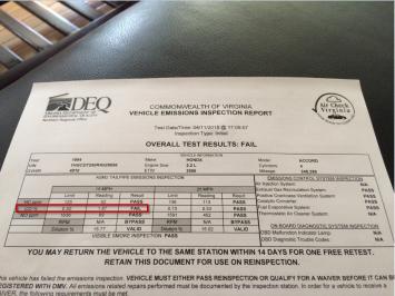

My ole 1994 Honda Accord EX with AT failed emissions test today.
Everything looks just fine and within the limit, except CO% at 15MPH, please see attached report and advise how can I improve or have the car pass emissions test.
Oil and filter was changed less 1000 miles ago. Air filter, spark plugs/wires were replaced for last emission test(2 years ago). For rack and pinion replacement, middle pipe with O2 sensor was pulled and when it was tightened up, think it produced a miner exhaust leak in that area. Can that be the reason for failure at 15MPH, since at 25MPH pressure is more and less exhaust gases are leaking?
Please see attached emissions report and thanks for any of your input and help.
P.S: There is no CEL, car does not miss or have any other noticeable problem.

Can you type out the readings, because I can't see anything on the attached pic.
Old Apr 11, 2015 | 07:58 PM
CO at 15 MPH is 1.87 with the limit being .5....at 25MPH the CO was .33 with a limit of .73.....
Anyway, if the plugs are two years old...the regular NGK's are only rated for 24K miles
Next if you "think" there is an exhaust leak,.....confirm and fix if so.

PAHonda, can you please try looking at the attached pict?
PM, can I try using steel band aid around the pipe area or proper gasket should be needed?
I am going to replace spark plugs and air filter. Is there a way I can actually see if there are any emissions improvements after the change?

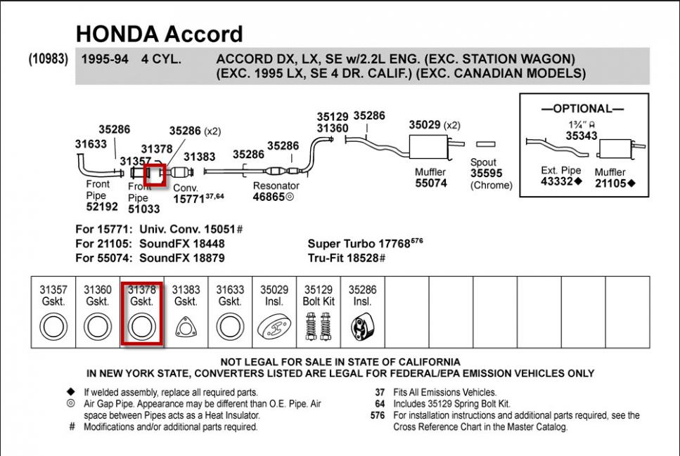

So I have the car up on jack stands and observed it yesterday, one of the gasket before the CAT(31378) isn't seated properly, as it that part was opened for Rack and Pinion replacement.
I have highlighted in the picture, going to seat it or replace the gasket.
Also, one of the spark plug well has oil in it, seal is leaking, can it cause emission related problems or no?
