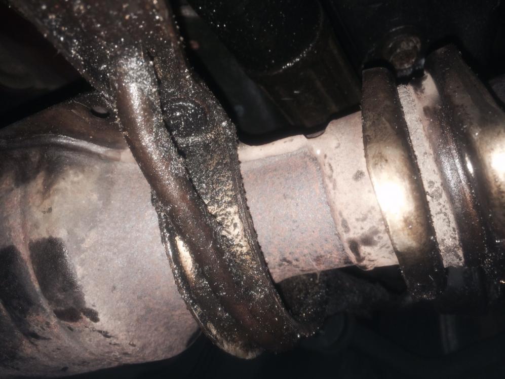

Yeah, I need to seat that gasket properly or buy a new one. What if I wrap muffler band-aid or something similar around that area?Would it cure the problem, you think or no? Because replacing these exhaust gaskets are a royal PITA.
Old Apr 16, 2015 | 04:49 PM
If you can make it airtight so it doesn't leak, it'll work until it starts leaking again. Just suspect that might not be too long because of the flexing around those flanges.

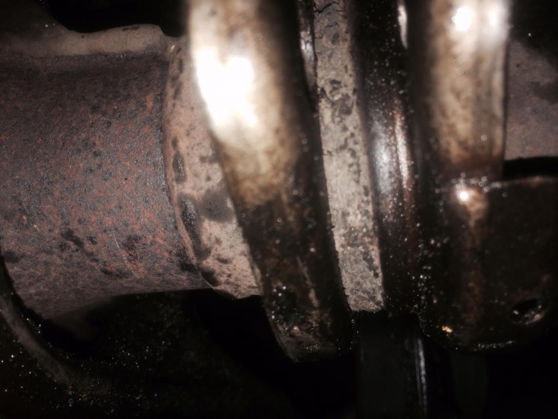

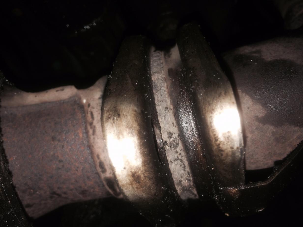

So I was able to crack the bolts for the gasket and connection between cat and middle pipe(with O2 sensor).
But pipe isn't moving at all. How on this planet earth I would pull the pipe out and take out the old gasket and add new one?

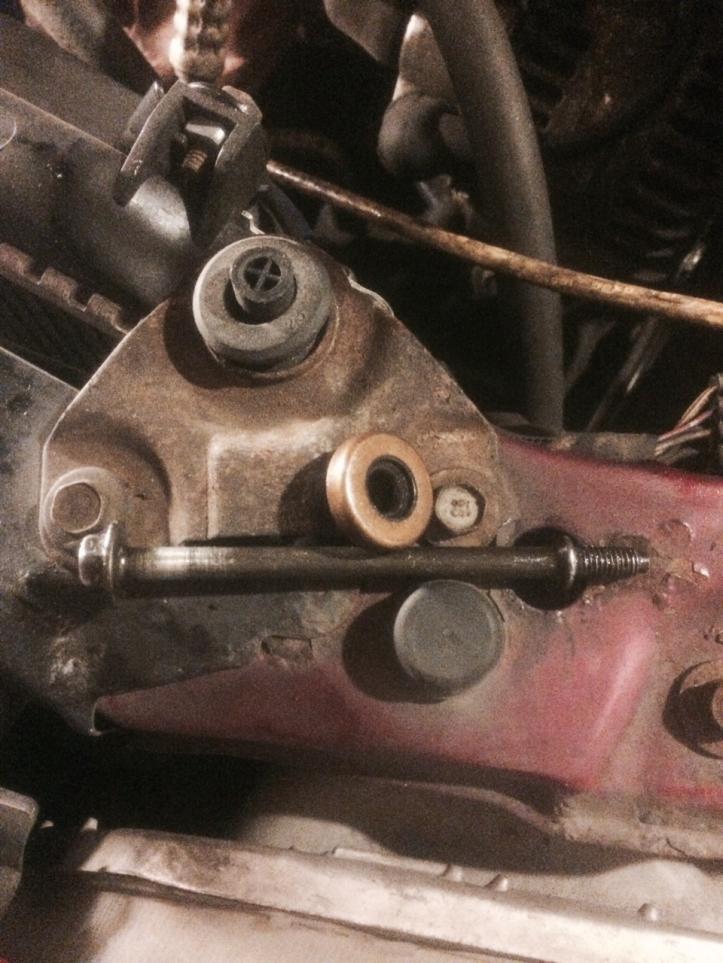

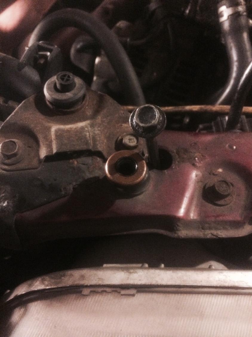

Also, is there a trick to put this grommet back on the screw for valve cover, I tried it and it's a PITA

Lube the grommet and screw it onto the bolt. Takes a bit of force.
Old Apr 18, 2015 | 09:35 AM
  #17
For the valve cover bolt, a piece of vac hose over the threads of the bolt....the outside of the vac hose should be right at the same size as the "shoulder" on the bolt....some oil on the vac hose and the inside of the grommet...the bad boy will slide on there with just a small amount of force.......done

Thanks so much guys. Dish soup and elbow grease did the trick, I would have never figured it out in my entire life time.

Black gasket actually worked and stopped any kind of exhaust leak close to O2 sensor area.
I used Seafoam today(1/3 of bottle through intake vaccum line) and noticed no smoke leak, but did notice leakage in the area where exhaust header meets exhaust manifold(pipe which has O2, Cat and eventually muffler), i-e first joint in the exhaust area.
I used lots of Red gasket in the area to stop exhaust leak, will report back tomorrow to see if I still see any leakage, else will use some more red gasket in the area and will take the car for emission test.
