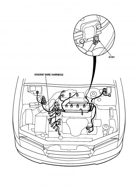

13 and 14 point towards a bad ECU. I have no code 18 listed, so that would mean a bad TCU or you counted the flashes wrong. I would stop by a u-pull-it junkyard to find an ECU from a 94/95 accord, automatic transmission, that is an EX. ECUs from manual transmissions, and LX/DX will not work properly.
There is a ground on the driver's side of the upper intake manifold that you should unbolt, clean bolt and eyelet with a wire brush or sandpaper, then reattach. See G101 in the pic:
Attached Thumbnails 1995 EX Won't start, Main relay OK, no power to fuel pump-pahonda-5547-albums-pics-2243-picture-g101-6236.jpg
