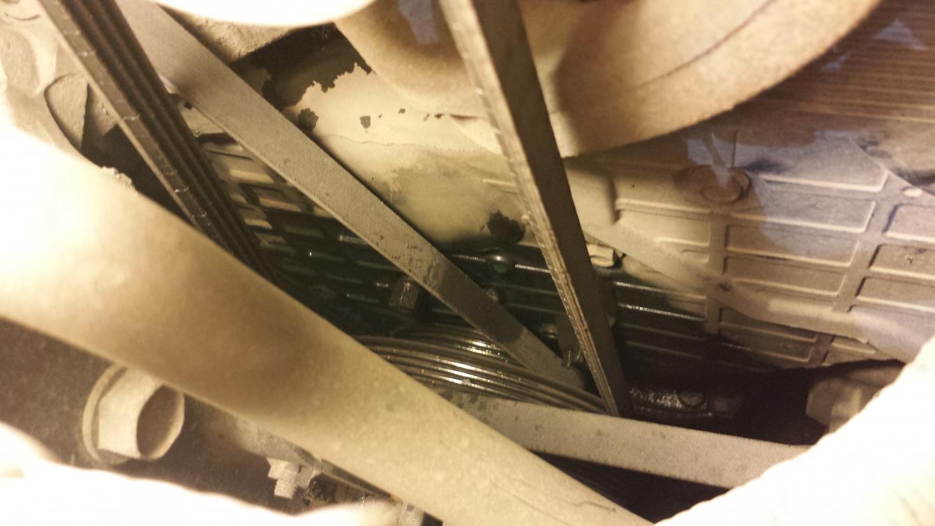

The first issue is the coolant leak coming from the weep hole shown. From searching here it sounds like a waterpump seal (Agree?). To do this job the search function on this forum has directed me that this job will also require a timing belt change. It seems all the info I find including the shop manuals I found in the FAQ all speak to the 2.2L. Is the job simular to the 2.2 or is there some other place I could find a how-to or shop manual?

Water pump will probably have to be replaced.
Instructions for timing belt for the V6:
1995 Accord V6 timing belt
Thanks for the reply, pretty much all right there. So I see a stubborn crank bolt, hoping some heat will fix me there. Looks like it shows how to align everything to factory timing there but will it be necessary? These belts stretch a lot so that just marking where everything is will be no good? Also would you guys recommend an adjuster belt pulley replacement or any thing else while I am there?

Thanks for the replies guys, the job went smooth and without any issues. You were right about the valve springs moving the cams so it was good to know how to set evreything TDC.
For anyone doing this, I ended up buying the crank pulley holder socket and was very glad I did.
