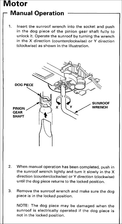

Alas, the service manual does not tell me anything. It shows me HOW to close it manually, but now how to access it. I can not find a plug anywhere, and I removed the dome light as well, thinking it might be under that. No luck.
Am I going to have to remove the entire headliner to get to the manual crank?

The headliner does not need to be removed to close the moonroof/sunroof with the wrench, refer to the picture I posted in my previous post from the owner's manual.
Go the Spoonertuner link in the sticky above in this forum section and download the Accord 1994 CD7 CD9 Coupe USDM Service Manual (45 MB) file. It is more comprehensive than the supplements for the 96 Accord.
94 -97 Accords are 5th generation Accords and very similar.

I did refer to the image you posted. That image says to remove a plug. Like I stated...my honda has no plug to remove.

Downloaded the manual. NO information on manually cranking close the sunroof. Pages (20-39 to 20-47)

Is your Accord a U.S. model? That picture is directly out of the North American 1996 Accord owner's manual.
The service manual show the circuit, etc., it does not refer to closing the sunroof with the wrench, as that is covered in the owner's manual, etc.
