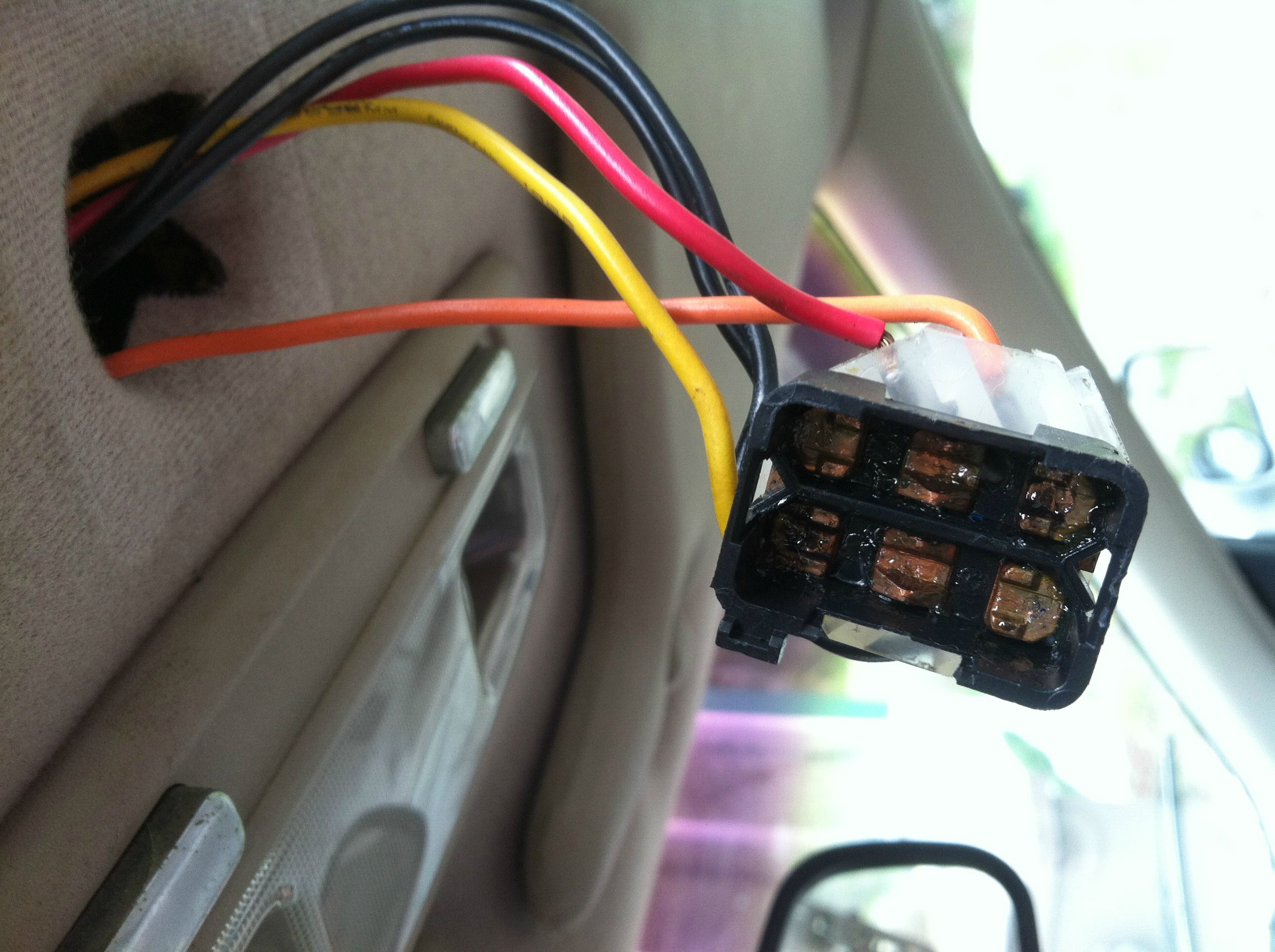

Sorry for the delay on this.
I have since learned that this sunroof is an aftermarket sunroof. no idea who made it. I am still trying to short the wires closed, but all I do is just blow the fuse. Attached is an image of the wires if anyone would like to take a guess.
Old Jul 23, 2012 | 06:47 PM
There could be a short in the motor causing the fuse(s) to blow.
I'd do a bit of investigation.....got a volt meter?
Two black should be ground at all times....verify both
One should be "hot" with key on or car running....verify but I'd start with the red one.
Then verify the other two are "open"/zero- or very small amount- resistance to ground. If so, one of those two is for "open" and the other should be for "close".
So jump the "hot" with key on or car running to one of the "other" two. Then try juming the other one of the two to the hot wire.
best I've got on this......would be nice to see the "rest" of the switch to maybe figure out what contacts it os closing in different settings.
