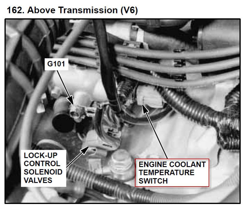

For the overheating problem, first check the coolant level in the radiator and reservoir when the car is cooled down. Top off the coolant as necessary and purge out any air from the cooling system by running the car with the radiator cap off. If there are air pockets in the cooling system, most of the purging will happen after the thermostat has opened.
If the coolant level is okay, ensure both cooling fans run. When you turn on the A/C with the car running, does both cooling fans run? If not, one or more motor may need replacement.
If both cooling fans run with the A/C on; but, doesn't when the car is beginning to overheat, then is may possibly be a problem with engine coolant temperature switch. If that happens, disconnect the 2-P connector at the temperature switch (see picture) and use a wire or small paper clip to jump the connector. Turn the car to ON, if both cooling fans run, it may be a problem with the temperature switch.
Attached Thumbnails 1997 accord 2.7 V6, 4 speed auto tranny over heating issues-ect-switch.jpg

Thanks for the info. Come to find out, its not the picture i posted, got to looking some more when i have some light, and it was a small hose behind the egr valve that has split, and it was spraying antifreeze out. The hose was not even 7 inches long probably. But again, thanks for the quick responses to my question. Awesome website, thanks again
