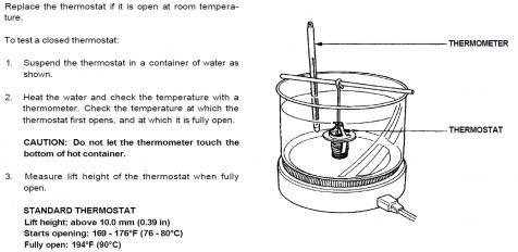

You can drain the system and remove the thermostat. Suspend it in hot water and see if it opens when the water gets to 194F. See pic.
The radiator is trickier to figure out, that is why I suggested that you flush out the system.
Hopefully it is not the water pump, because you might as well get the TB replaced.
