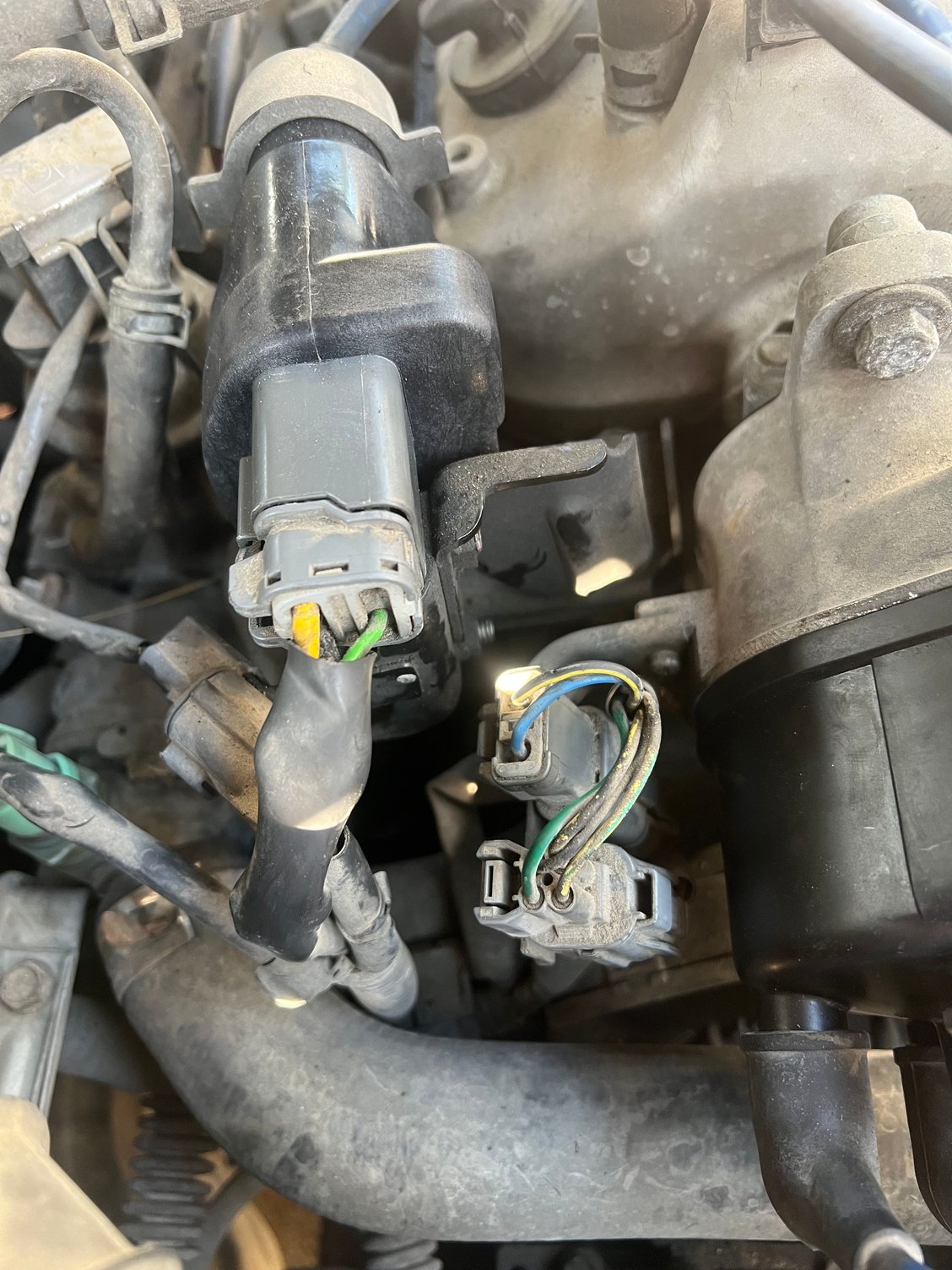

Hi guys. Have a 1997 Honda accord LX 2.2L non vtech. Car died on the road and now doesn’t start. Have no spark at the plugs. Replaced distributor cap and rotor. Ignition coil. Ignition control module. Hooked up a reader and have no codes. Tested crank sensor resistance and seemed good according to some numbers I saw on here. Any ideas what I should try next?

I have a meter and a power probe. And yes I can hear the fuel pump come on when I turn the key on, I haven’t replaced the main relay because of that. And can definitely smell gas when trying to start

Check that you have 12V with the power probe to the blk/yel wire going to the distributor and coil. At the coil check that you have 12V at the yel wire. The key needs to be in the II position to do these tests.

Forgot to mention this car has the TEC distributor if that makes a difference. Will test with power

The wiring will be slightly different for a tec distributor with the internal coil. How did you modify the wiring to install the tec version? Was the tec installed not long before you had the no-spark issue?

Checked voltage at yellow and black at coil and distributor. Got 12 volts there. Checked yellow wire at coil. Got nothing

I bought the car 2 years ago and it came with the external coil

Sorry, long day. The LX and DX had the tec distributor with the external coil. The EX had the hitachi with the internal coil.
The wire colors and tests were correct. Also test for power at the blk/yel wire at the coil while you are at it.
Did you test the yellow wire with the connector unplugged or back-probe with the connector plugged in?

i tested black and yellow at both distributor and coil. Both 12v. For the yellow wire at the coil. I unplugged at and tested at the plug
