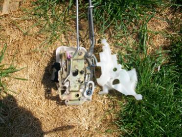

1998 Honda Accord EX Coupe
I got my door fixed. I had to take the door pane off,l removed from the inside. After that choir was completed the latch had to be drilled out from the inside of the car.
Here are pictures of the latch after drilled out of the car.
Remove the white plastic cover and drill right in the center with a 1/2" drill bit.
Attached Thumbnails 1998 accord coupe door problem-latch.jpg   1998 accord coupe door problem-latch2.jpg
