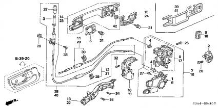

Just inserting some reference schematics I found online...
All #'s have associated p/n's which I could look up and order. Sweet. Honda actually has got it together nicely.
