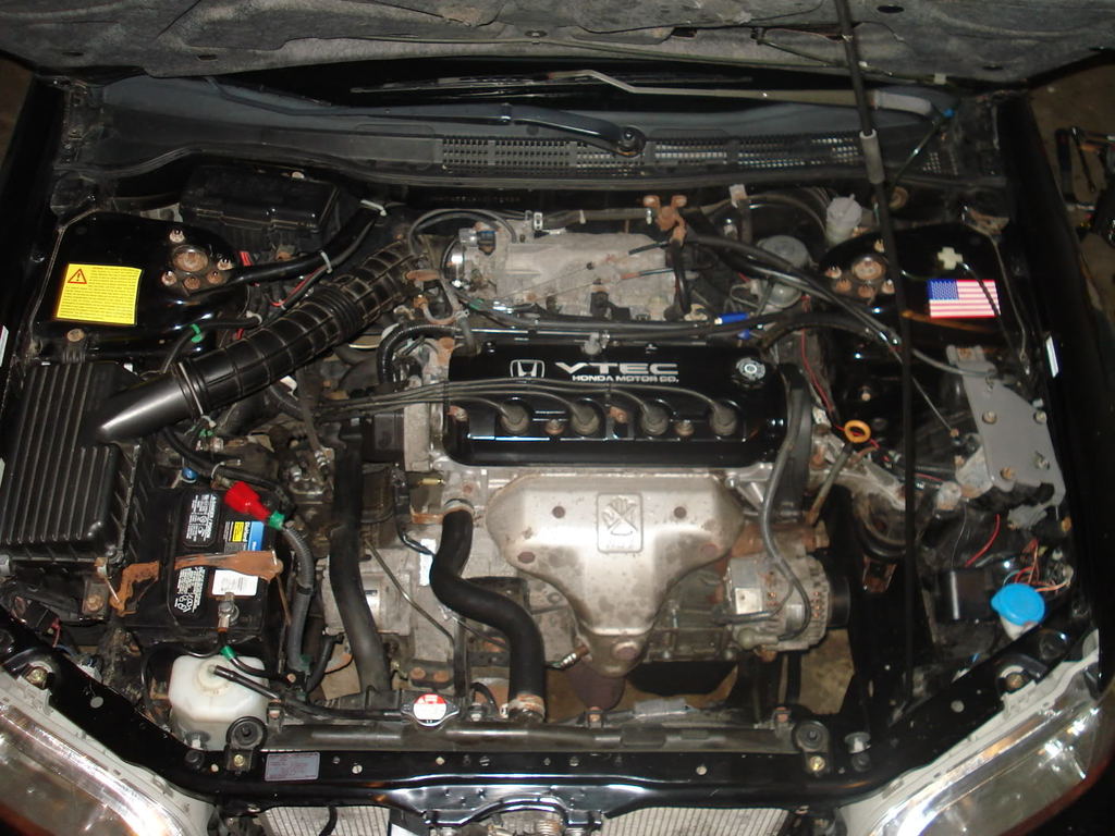

It sounds more to me like you have a small leak in the clutch hydraulics, so when you hold the pedal in, some fluids leak past a piston and the pressure decreases. When the pressure decreases and fluid leaks out, the piston/rod that gets pushed out of the clutch slave cylinder while slowly go back in and the clutch with slowly get engaged without you wanting it to. I'm betting that this is wearing the clutch out in the process. You should find the clutch slave cylinder on the front of the transmission housing and follow the hydraulic line to the clutch fluid reservoir, looking for leaks. Also check the interior where the pedal and master cylinder are for leaks as well.
The Clutch salve cylinder is the thing held onto the transmission housing with two bolts and a metal hydraulic line going to it. It's right "above" the radiator cap in the picture.
