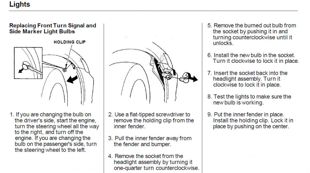

My front right turn signal bulb burned out.
How do you get to it?
The book I have shows a two piece headlight/turnsignal assembly. The one on my car is one piece.
Do you get at it from the bottom or through the wheel well? Or is there some other way?
Thanks.
Old Jun 25, 2011 | 04:18 PM
Through the wheel well.
