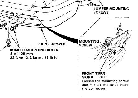

my manual shows two screws, one in front and one on top but there is none in front i can get to. i can see it under hood but no way to get to it. any help would be appreciated as i want to be legal... j

See if this helps......
Attached Thumbnails Replacing font turn signal bulb '91 Accord-4th-gen-frt-signal.jpg

thanks, yes it helped. i was looking at the wrong light...
