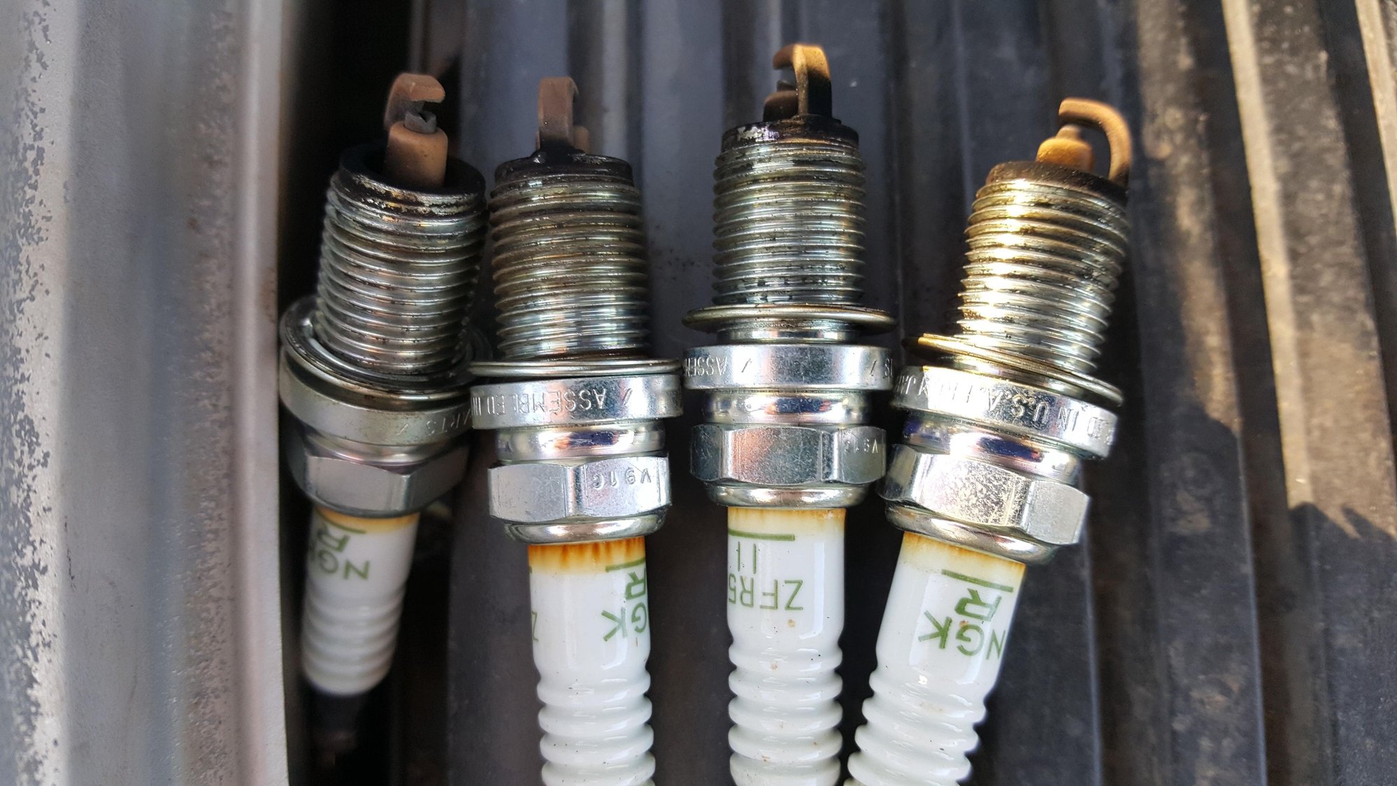

I have been changing my spark plugs every year or two. The last time was after I had misfires. This is how they looked:
According to this chart I think they were okay. Is it big enough?!

Your spark plugs look ok to me, but spark plugs can be hard to read if you don't have a drastic problem. Your car calls for NGK ZFR5F-11 spark plugs that should be replaced every 30K miles (I don't go by the years on the spark plugs). For plug wires the OEM Honda wires seem to last forever, where aftermarket can degrade and cause a misfire. NGK is also a good alternative aftermarket brand. What code(s) did you get when you had a misfire?
