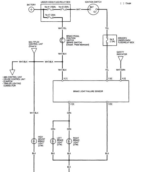

I am trying to figure this out and I can't so I am hoping someone can help me out. I have a 1999 accord coupe and the other day my brake lights quit working all at once. All of them except my brake light on the inside back of the car. I know my brake switch is good and my fuses are good so what would cause all of my exterior brake lights to quit working all at once? My normal lights and turn signals work fine just my brake lights when pressing in the brake. Thanks!!
Old Jan 16, 2012 | 06:27 PM
Double check the fuse in the drivers side underdash fuse box. Check the ground as well.
Any recent work done to the car?
Attached Thumbnails 1999 Honda accord coupe brake lights-6th-gen-brake-lights.jpg   1999 Honda accord coupe brake lights-6th-gen-rear-wire-harness.jpg
