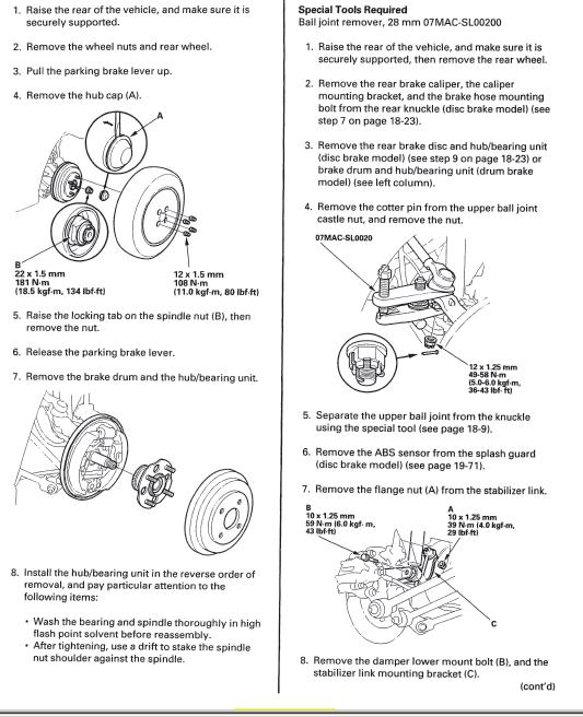

what is the torque spec for the large wheel bearing nut ? 32mm ish
front someone told me was 180lbs is that correct and the rear is ?

Front, yes 181 ft lbs
Is the rear disc or drum? They are close so not sure if it really matters
Rear Disc = 139 ft lbs
Rear Drum = 134 ft lbs
*According to the manual I have.

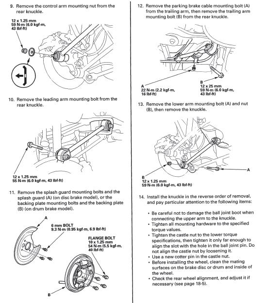

Upper or lower arms? For ~$27 you can buy a pretty nice service manual for the car

for rear drum style the torque specs i need are
backing plate to spindle ---
all 5 control arms both ends ---
lower shock bolt too ---
wheel torque is 80lbfts?

Are you replacing the rear knuckle?

thank you this should do it for now . the car slide into the curb over the winter and passenger wheels buckled in. so replacing a bunch of stuff
