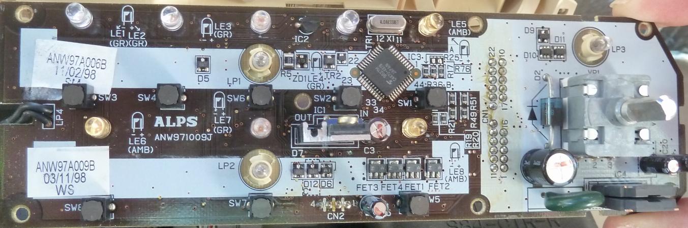

I have had intermittent A/C (all lights turn off, fan blows) in my 1999 Accord LX car - I don't have climate control.
I have done the following:
  • Checked all fuses and they were fine.
  • Opened up the board and there is no corrosion (picture included).
  • Checked cooling fluid.
Often when it's not working, plugging it back in (green connector) seems to do the trick.
Any ideas?
Thank you
Attached Thumbnails 1999 LX intermittent A/C (w/o climate control)-board-back.jpg   1999 LX intermittent A/C (w/o climate control)-board-front.jpg

There might be an issue on the board.
Do the tests as TX described.

I might have described the problem incorrectly. The entire heater system kicks out not just the A/C (all the lights go out and only fan speed **** works). I think it's more connected to the control panel but I don't know why it's intermittent and not just completely dead.
