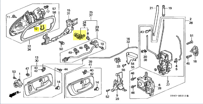

Old May 10, 2012 | 07:54 AM
Check to see if the clip is there or not holding properly.

Old May 10, 2012 | 11:16 AM
canada_dude's Avatar
Joined: May 2012
Darn! You guys hit it right on. There is no clip! The folks that repaired the door the last time didn't put it back, sigh... Can I order it? What's the part number for that clip? Also how hard is it to put it back on? Should I just pay the dealer to do it ?
I only have very basic DIY knowledge. Thanks!
Old May 10, 2012 | 11:29 AM
The Honda part number is 72123-SR0-003. Honda list price for USA is $2.10, dont' know about Honda Canada. Get the part through your local dealer, not worth paying shipping, etc. via the internet for that.
Do it yourself, you already know how to take off the door panel to access it. Probably just need to use a pair of needle nose pliers to install.
