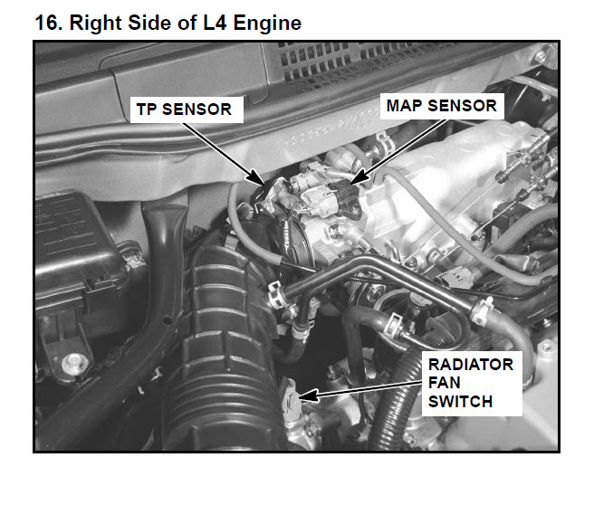

First, do both cooling fans turn on when temp is high and AC is Off? If no, the radiator fan switch may have failed open. Radiator fan switch appears to be (honda shop manual) on upper radiator hose fitting at the engine side. You can short connector to switch to simulate closed switch. Fans should both run as soon as keyswitch is On. A boiling water test can be done to confirm switch is closing or not at 199F to enable cooling fans.

Old Jun 23, 2014 | 04:00 PM
Radiator fan switch is located on thermostat housing, connected to lower radiator hose.
