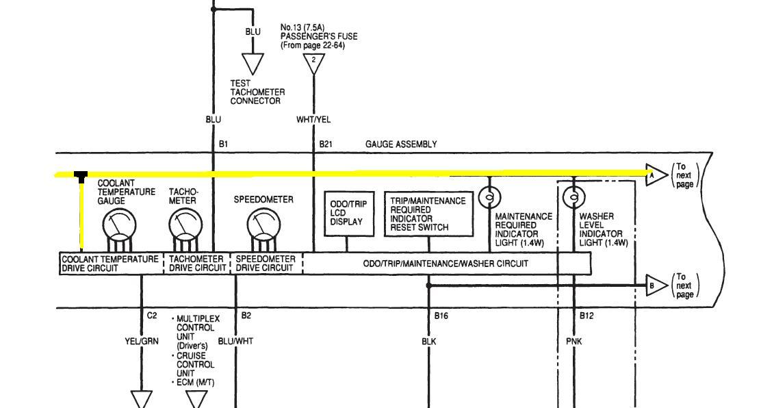

Still sounds like a fuse (#9 7.5 amp) drivers underdash.
Don't know if this eye chart will make sense, you can see that power to the "green key", charge come from different fuses. The YEL wire from the fuse ref above goes to the "rest" of the cluster (high level)... page two where the YEL wire goes to the right shows where it powers the tach and that.....also to your point the VSS is powered by another fuse.....so long story to say PLEASE double check the #9 fuse.....
Attached Thumbnails 2000 honda accord electrical issues-6th-gen-gauge-cir-00-02-4-cyl.jpg

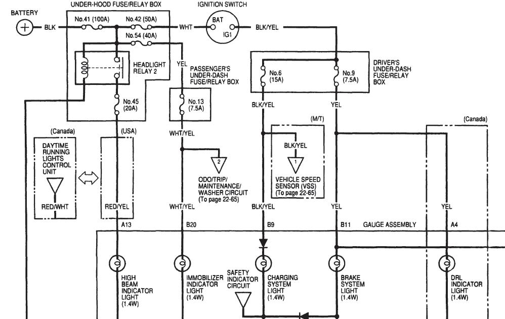

Old Oct 2, 2012 | 07:35 PM
and here is "part 2"....did I ever say I hate electrical issues ?
I broke out all of my "paint skills" to highlight the YEL wire
Attached Thumbnails 2000 honda accord electrical issues-6th-gen-gauge-cir-00-02-4-cyl-pt2.jpg
