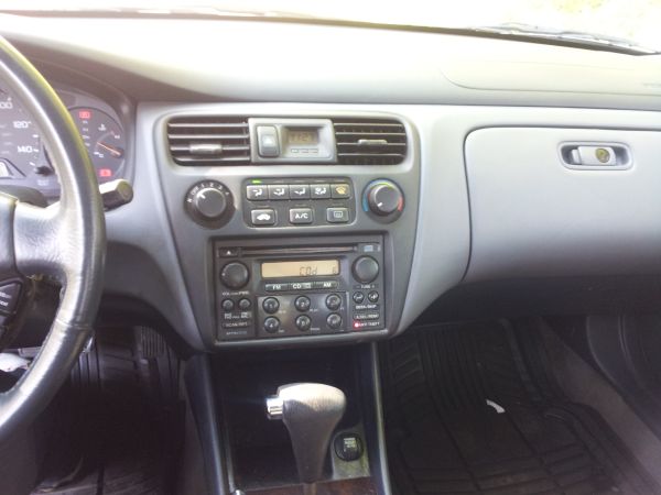

Old May 3, 2013 | 06:01 PM
That sound smore like the auto HVAC.
This pic is for "manual HVAC" controls.....the **** to the right is the hot/cold "setter"

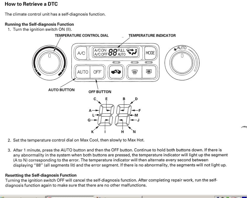

Old May 3, 2013 | 06:06 PM
This is the "auto HVAC", note the "auto" on the ****.

Old May 3, 2013 | 09:11 PM

Old May 4, 2013 | 09:41 AM
In the pic for the "auto" AC - the procedure for checking for HVAC codes is included. Please check the codes as it lists.
I'm guessing one of the mode or mix motors but want to check the codes first.
Old May 5, 2013 | 02:29 PM
Milanodan's Avatar
Joined: Jan 2010
Posts: 17
From: Litchfield Pk, Arizona
Did the check--NO codes set.
