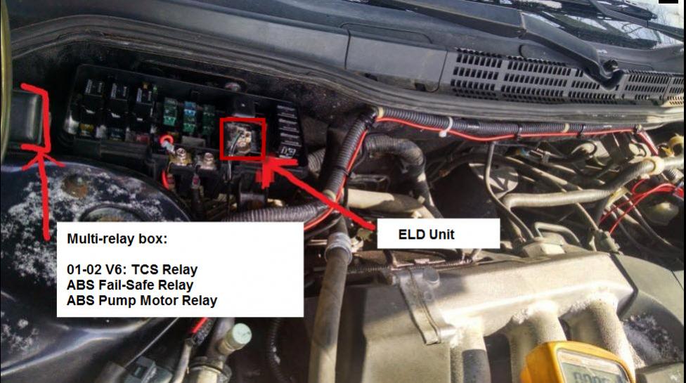

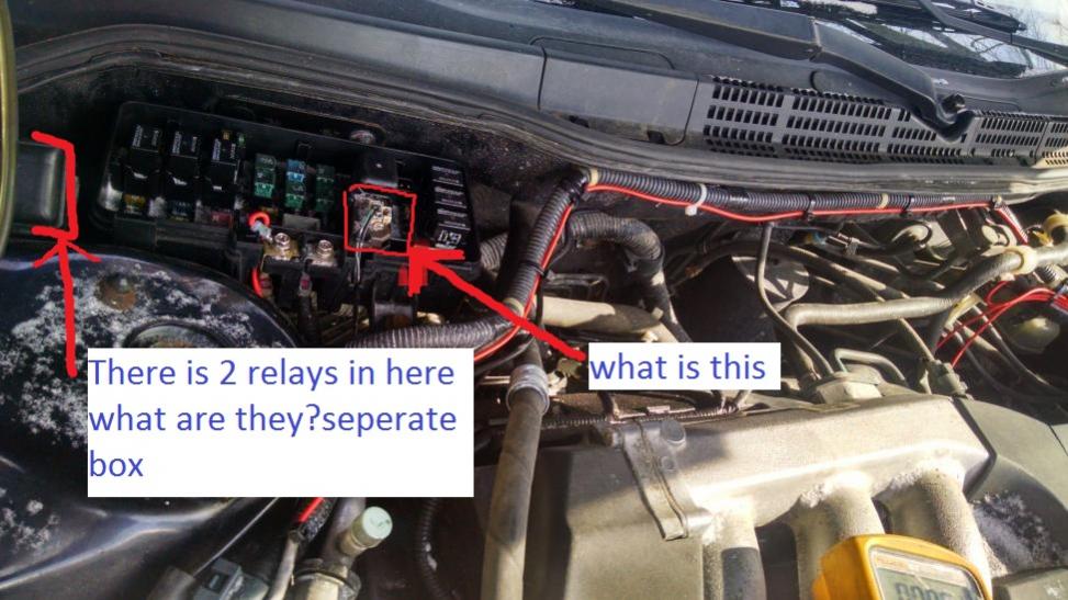

Hi Red , and everyone else , I have a question regarding the underhood fuse box , attached is a picture, just trying to find out what they are and if they relate to my starting / driving problems
Attached Thumbnails 2002 Accord Alternator/Ignition charging issue-honda-accord.jpg
Old Feb 20, 2015 | 10:45 AM
  #50
See attached image of notes I added to your photo.
The Electronic Load Detector (ELD) unit is part of the charging system circuit. So, yes it can be a source of your problem.
Honda's utilizes a dual mode charging system to increase fuel efficiency and reduce drag on the engine on start-up. The ECM/PCM determines charging based on info. from the ELD. During heavy load, the ECM/PCM can set charging voltage for high output (~14V - 15V). During light load and start-up, the ECM/PCM sets charging voltage for low output (~12 - 13V). The ECM/PCM can control charge modes (high or low output).
The Blk/Yel wire to the ELD unit should also have ~12 volts from driver's dash fuse no. 6, with the ignition in ON or START.
Attached Thumbnails 2002 Accord Alternator/Ignition charging issue-under-hood.jpg
