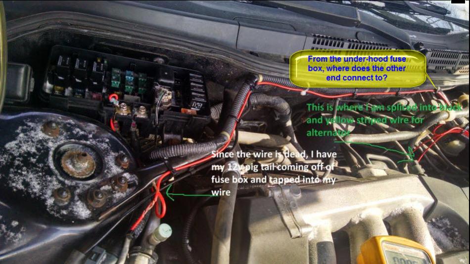

this is my splice in and connection... Under the hood fuses are showing voltage except for the center 3 with key on
Attached Thumbnails 2002 Accord Alternator/Ignition charging issue-honda-accord-under-hood.jpg

1. From the under-hood fuse box, where does the other end of the wire connect to? -- You may want to take some close up pictures of that area.
2. What do you mean by center 3 fuses?
Attached Thumbnails 2002 Accord Alternator/Ignition charging issue-re-route-wires.jpg
