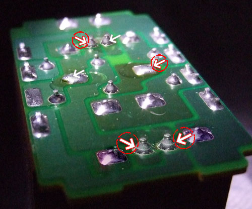

I also was reading about the main relay could have bad soldering joints on it in places, I will ck this
Check my post on page 1 from earlier today. There are a couple of indicators which will easily tell you if your FP is getting power or not. The solder connections you need to resolder are the coil connections for each coil (two pins close together as indicated by photo) and the leads from the ceramic resistor.

Thanks Blackwater, I have checked the solder joints and they appear to be fine. One thing I am suspicious about is the Ignition Switch. It feels sloppy when inserting the key and sometimes has to be coaxed to turn. Could this be the problem?
I haven't had any trouble with the car since the first time it didn't start so it is difficult to say if it will happen again.
I would think the key wouldn't be a problem unless you have the immobolizer feature, even though you have to jiggle it on occasion. If the transponder goes bad or the ring goes bad it would likely be a permanent thing.
As to the solder connections, the hairline crack which indicates a cold solder joint can be so small (much finer than a hair) that you might not be able to detect it even with magnification so it would be a brief and simple exercise to resolder and put that possibility to bed.

I just now tried to start the car and I noticed that the green key light does come on, I heard the fuel pump, and the car started.
I did remove the relay board and checked all the solder joints with a magnifier glass. All the joints were shiny and none had any cracks. I have worked with electronics for several years and have seen many bad joints and these all appeared normal. I guess if it happens again I will remove the board and try resoldering them.
