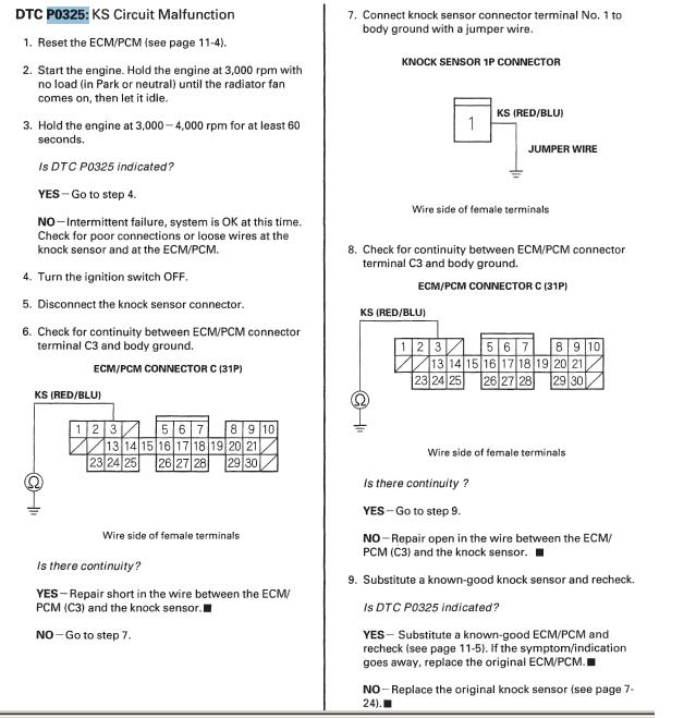

Old Feb 4, 2012 | 06:39 AM
In the testing, they tell you to hold the rpm's @ 3 to 4 and see if codes sets.

I confirmed the wiring is good as per the test.

Judging by the testing that Poorman posted, you rule out any problems with the wiring, the PCM, then replace the sensor. The circuit is dead-simple; just a single wire straight to the PCM. What kind of sensor did you use? I'm sure it's like O2 sensors & spark plugs - Honda doesn't actually make the sensor, it's probably Denso or something like that.
