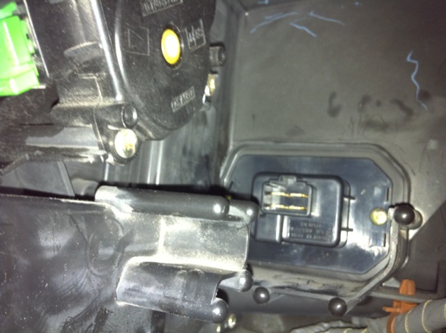

OK, I will admit I was a little skeptical but it worked perfect! The 1 thing that had me confused was, everything I read said the fan would work on high if the transistor was bad, but mine wouldn't work at all anymore. I opted to replace the whole unit instead of repairing it. The 1 thing that was a pain in the rear was the screw on the left, it is right next to something that wouldn't allow me to get my fat fingers in there. But I quickly learned that if you swear at it enough it will come out... I attached 2 pictures so you can see what I am talking about (the transistor is the darker black component in the pics).

On older accords, the high temperature setting would work, because the electronics were different on the equivalent. It was three resistors in series, so you had four fan speed settings. Your blower can run at infinite speed settings depending on how the speed control is set up.
Glad you got it fixed.
